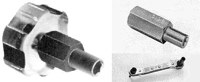

I went to the dealership and was told that the 5.5 refers to the driver part of the bit but my set shows a different # for each bit. I'll have to try blowing it out to see the what it is, slot, phillips or hex. :bawling:
Ok, the TFI is held on by two screws. Generally speaking they are 5.5mm hex heads.
A very small percentage have a round head with a T15 (I think it's a 15, might be T20) torx boss.
There is a tool available at advance auto, costs about $5, and slips down in the hole, has the right socket on the end for the hex.

Thanks for the tips on the torx bits although it feel like the flat head bit fits when I try it by hand and I couldn't get either torx to fit in by hand. I just can't get the flat head bit to turn with the little rachet I bought at the tool store: http://www.harborfreight.com/8-piece-right-angle-screwdriver-92630.html
Maybe it's a hex with a slot in it for a flathead. A hex would probably be easier to turn.

This is what I am talking about.

I had some time today and got the distributor out to reveal the once hex heads. They're rounded off now. Maybe I can drill them out. Any better ideas? :icon_confused:
NOTE: Actually, I have a distributor from a 2.9 sitting on the bench that has NOT the type you are looking at (as far as wrenches go).
It is called an "INVERTED TORX" and has a rounded head, the torx is "inside out" so to speak.
I don't think the Ford wrench is this, (I could be wrong) but the wrench that ADSM posted in his picture on your first page, is a inverted HEX.
ADSM ? correct me if I'm wrong....
