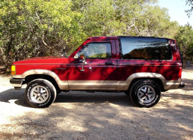

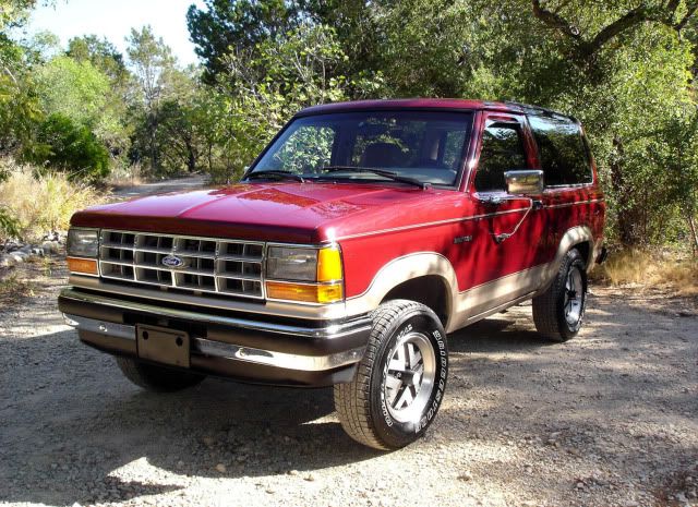

Here is "89" Esmeralda. She is maroon not red.
Ponyup, Nice BII!

Nice BII by the way! Looks great!
