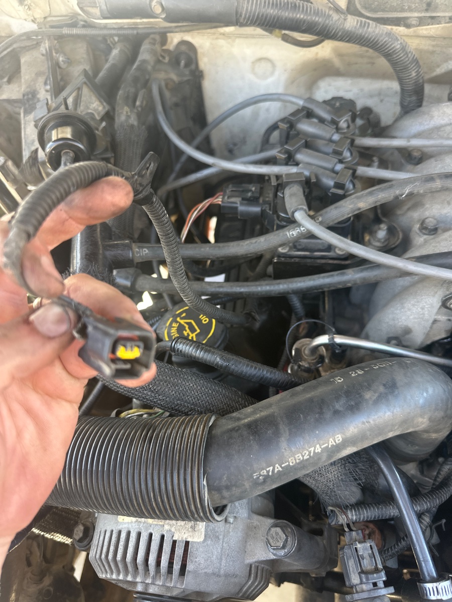

OK folks. I just put on new head gaskets and I am connecting everything back up. The only problem is I can’t figure out where this one connector goes.
I have the pre-July 1998 heads 3 L Ranger. This connector comes off of the coil pack the MAF sensor and the alternator harness. This connector branches off just after the last fuel injector and also the MAF and alternator. Can anybody tell me what it goes to? It’s a two pin connector.
  • Where does this connector go??  Help!
Very carefully look and write back in the wire colors. It can be difficult, the colors like to fade from the engine heat. And turn them around, they may have a stripe. List the main color first, the stripe next. Then we might be able to find it in the wiring diagrams. 1998 3.0 4x4 ranger? California model?
I found it. It went to the crack Sensor. Pulled all the accessories off just to find it. Passenger side pointing up at a 45 degree angle. Ugh. Thanks for replying!!
