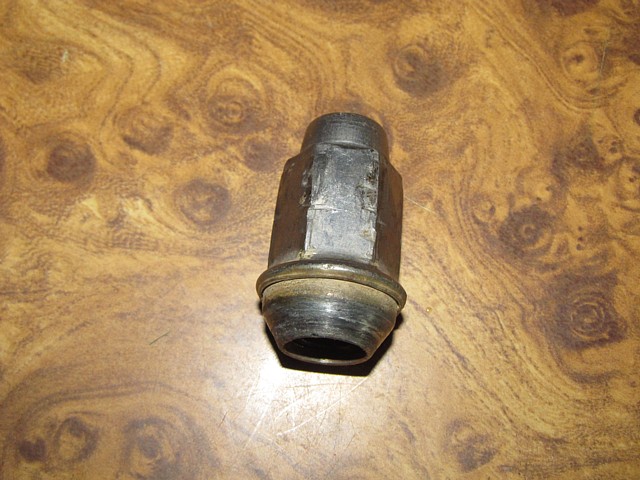

I agree that something looks wrong with those nuts. Aluminum wheels often take a different style lug nut than steel wheels. Maybe someone with the original Alcoa wheels like those could chime in.
My BII had those wheels on it originally... It had these dumb Ford nuts with the thin tin shells that the shells tended to fall off after tightening them a few times (hex size is ¾"). I reused those lugs on a set of ProComp Rock-Krawler D-hole steel wheels for years, and briefly on the set of AR Baja something-or-'nother (8-hole) aluminum wheels I have on it now.
But yeah, something about the lugs on eightynine's pic doesn't appear correct (like they're too big/fills up the recess in the wheel too much). We would need to see the seat type to know for sure though.

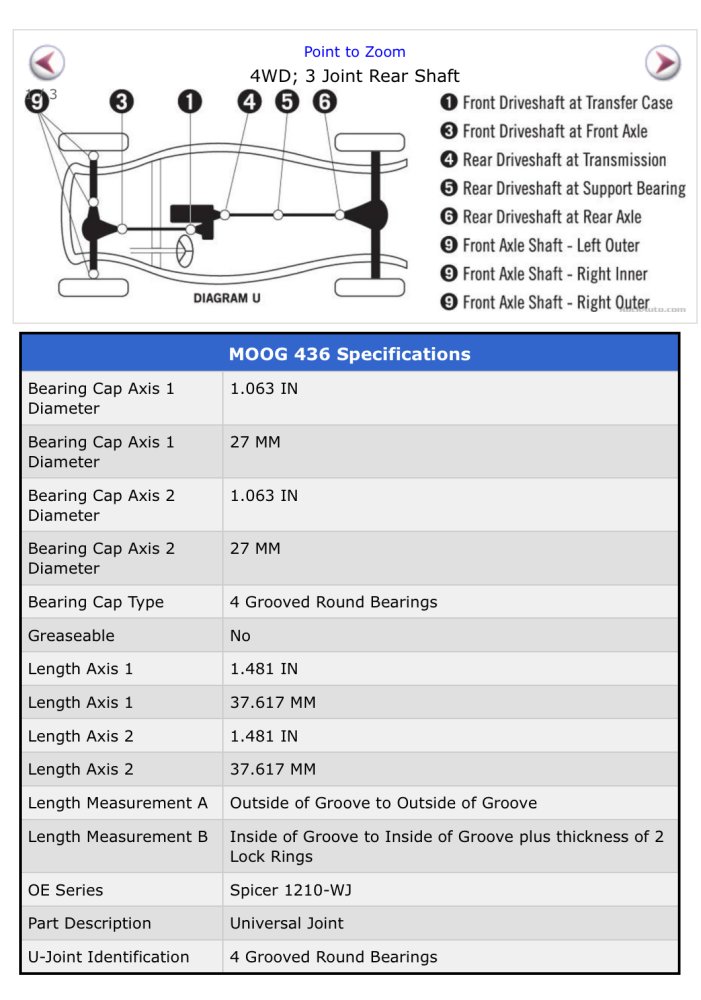

Update: seems like the MOOG 436 is a good choice for all 3 up front?
It’s weird.. according to every list of parts i can find, the only locations mentioned are “Right Outer” and “Right Inner”, even on Moog’s actual website for the 436 below and on all listings in rock auto. Nobody mentions “Left Axle” at all.
But when looking at Moog’s and other manufacturer’s drawings… they all visually point to the three locations on front axle and give them the same part#. In Moog’s case it is #9.
So i guess MOOG 436 is fine for all 3.
