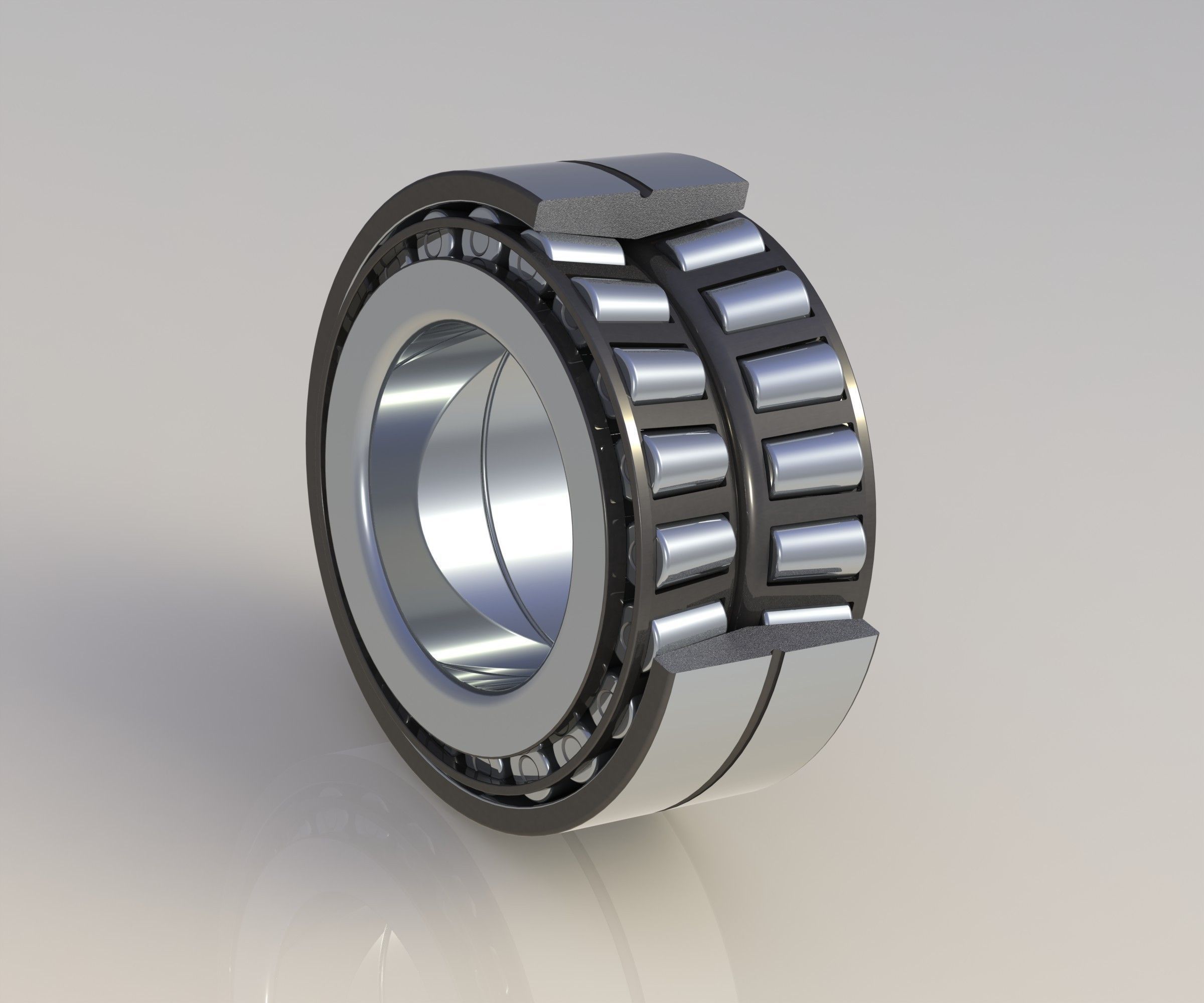

The pressed in sealed bearings you are looking for can last as long as tapered roller bearings but you have to buy quality bearings (not parts super store bearing like AutoZone or Pep Boys), they have to be installed with a press and the proper bearing plate, and a few maintenance "secret" tips for best results. BUT the expense of doing the conversion so you can use such bearings is just not plain worth it. I'll take tapered roller bearings over a pressed in bearing any day. If it ain't broke, don't fix it.
That's not even remotely true. Tapered bearings are designed to carry and spread/centralize the load on them. Standard radial bearings were NEVER designed to resist or carry an axial load. They're fine for a rear axle but far less than ideal for an axle that turns left to right and has to resist side-loads when cornering.
may I suggest you look at a cut-away diagram of a typical sealed front wheel bearing. they definitely are designed for side & axial loads.
Ford Taurus' used a dual roller cartridge front bearing thru 1996, not sure what newer ones are.
My Honda CR-Vs had them. The first one had about 160,000 miles on it and never changed a bearing. My second one only had the front left changed because it had become one with the CV shaft that needed replaced. That's when I found out about aftermarket bearings and replaced it yet again with a Honda bearing. At 20 years old, none of the other bearings have yet to need replaced and those bearings are used on all four corners.
That being said, I still prefer tapered over radial bearings. Easier to work on and less finicky to remove and install.
The pressed in I have been around are a double tapered bearing. Kind of two bearings (like my Ranger) in one sealed unit.
