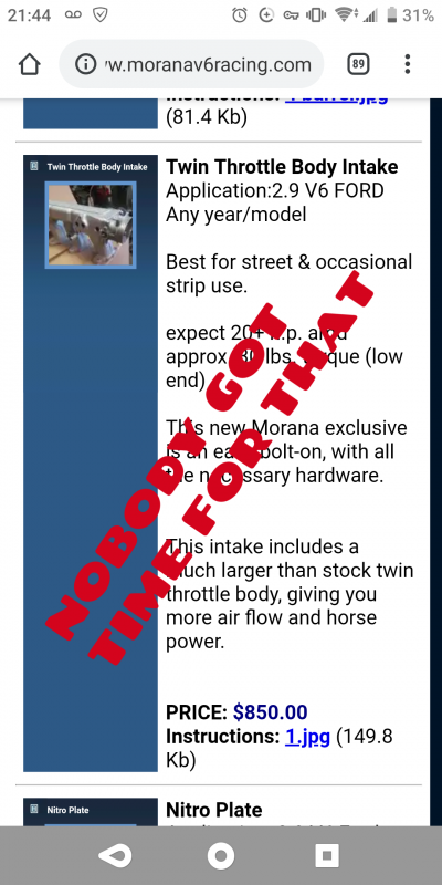

This stuff is pricey but hes got alotta cool trick 2.9 stuff, if for nothing else to dream about...
