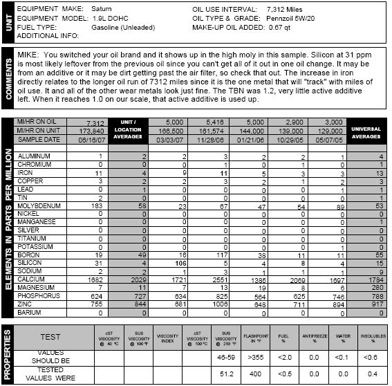

The ignorance in some of these posts claiming wax, sludge, etc would be laughable if it weren't so pathetic. Some are using the wax B.S. for a scapegoat for either poor maintenance or other factors beyond their comprehension or ability to research. Others are just indulging in stubbornness or self-righteousness which makes them appear even more uneducated. These kind of people will always be found and hinder progress with their ignorance and blinders. As far back as the earth is flat and the earth is the center of the universe all the way to 'I can make candles out of the wax in my engine from Pennzoil' and the like... Sad.
Below is a UOA of Conventional Pennzoil, 5w 20.

Read where it says sodium, its from the salts derived of H2O and what bad is most of those chemicals are in our tap water.

pardon me but i dont get it :icon_twisted:
explaint to me please
it does have a wax in it when the oil gets hot and starts to burn the water evaporates out thats whats left behind the wax causes the soot to build up around your valves springs and even your rods. .
Wow. That made absolutely no sense whatsoever. So you're saying Pennzoil adds water to their oil? You ever hear the phrase "water and oil don't mix"? And once the water burns off, all that's left is wax? LOL.
Sodium is a very common additive used in a lot of motor oils as a detergent.
Here's an analysis of Castrol GTX. Look it has sodium in it! And read the paragraph in the report "Sodium increased to 241 ppm...we believe it is from an additive in your oil."

yes its a water solluble petroleum "breaks down and loses viscosity" from just engine sweats or condensation, and the so called wax isnt wax its acually left over silicon and additives from the oil being seperated wich is normaly caused by the stress of driving it, it stays behind as the oil breaks down and burns out and yes theres water in it. its one of the things that they seperate from the crude, why do you think pennzoil leaves so much crud behind in your engines when at 7000 miles you pull your valve covers and youll have quite a bit of gunk or deposits left behind do the exact same test using a different oil, go the same amount of mileage doing the exact same driving and then do the same thing and you will notice a much cleaner engine.p.s who ever said they put parrafin wax in oil that parts not true the so called WAX is acually the silicone that got seperated from the oil as it burns up. and those tables are the used end product we buy at the store not the crude thats being pushed through refining. as we ALL know the oil we buy at the stores floats on water, how do you think they seperate it makes it much easier to pull the mud and crap out of it, then run it through another process which in turn start adding the additives, and sodium isnt the only element on those tables thats from our water either if some handed me one of those spec sheets my first response would be muddy water. just because they seperate water from it like I said, doesnt mean that what is in those containers from the store, and its not me that is being made an ass you tell that to the chemical engineers that build those refineries, I am only going on what I am told by them. almost all of our conventional oils are processed like that.by the way what the hell you think is in our oil when its drilled? MUD and water! which they seperate from it as well as the methanes and other natural gasses from the crude. thats what the refining and filtering of the crude is for.
