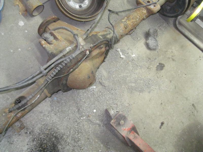

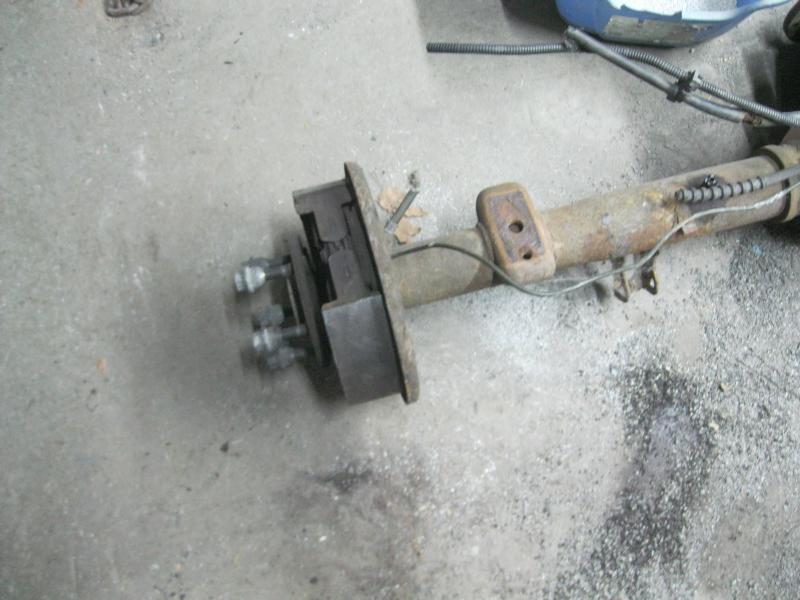

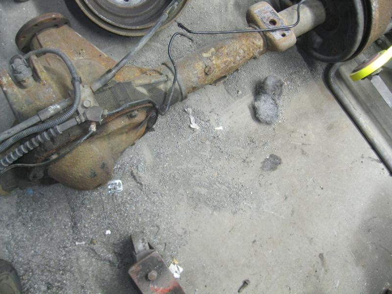

Thanks. Do you happen to know what type of axle this is? It's from a 2004 Ranger and the tag reads V333L 4L10 88 4C11, but I don't know if it's 28 or 31 spline, or an open or LSD.

8.8 4:10 Limited Slip.
You have to measure the axle tube diameter to determine if its 31 spline. 3-1/4" is 31 spline, 2-3/4" is 28 spline.
There's a step in the axle tube which I'm pretty sure means 28 spline, but I'm not familiar with the Ranger 8.8's
Yep, 28-spline, and should have the Traction-Lok limited slip diff.
I think they both have a taper at the end of the tube, one is just more tapered than the other. :dunno:
I was talking about the taper between the diff housing and the spring perch in the above pictures, unless I'm seeing things...
Another easy way to determine if 28 or 31 spline is to look at the drum brake backing plate nut spacing. Looking from the back side the 4 nuts form a rectangle on 31 spline, they form an inverted trapezoid on the 28 spline with the two lower nuts closer together than the two upper nuts.
