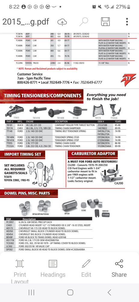

I'm looking for the part number or at least the name of this part to help searching for a replacement. After pulling the head and replacing it, my son snapped the stud that the timing tensioner spring pushes against. I'm pretty sure this part can be from many different years, but his truck is a '97.
  • What is this part?
With a lot more google searching I found what looks like the stud in question. It is listed as the tensioner spring stop in the one I found. However the ford OE part number (E7ZZ-6E008-A) listed is old and hard to find anything other than ebay postings with that number. Does anyone else have a newer part number or at way to make sure the part number listed above is good for a 97, the catalog shows it for the Ford 2.3 from 74-99...

I would say yes, because that same basic timing tensioner setup was used for all of the Limas and the 2.3L blocks are pretty much interchangable.
