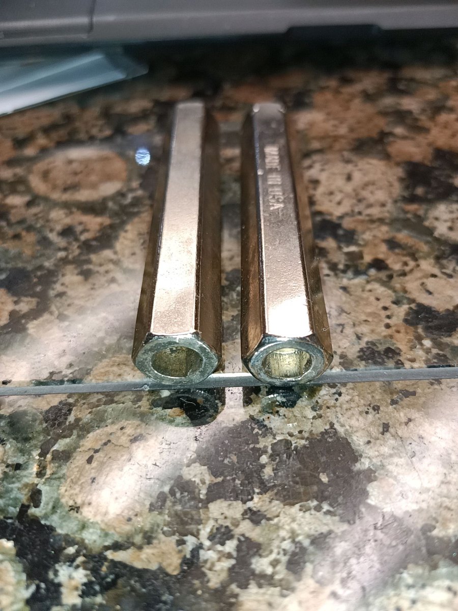

I was struggling to hold in place, the tip of a 1998 2.5 strut, then unscrew the nut just below. My neighbor lent me these two tools and the process was a snap. He has no info on where he got them from, might have been a garage sale whatever. I searched and Google pic cam search is not bringing the correct item. I searched and bought strut nut sockets on Amazon but they are way too big. What is this tool and any link where to buy them?

Before I want to prison I bought a tool like that at AutoZone.
The tool was two pieces.
One of the pieces was like those two tools you have pictured in your picture.
The other piece was bigger around and shorter.
They were a tool for doing rear shock replacement.
You would put the tool that looks like the 2 tools you have shown in your picture on the piston rod
( I'm not sure that's the right name or not. Hopefully it's close enough that you understand. )
that comes out of the top of the shock that the 2 rubber grommets that goes on each side of the body of the vehicle go on to with the washers.
and the nut.
The bigger diameter one that was also shorter would slide over that tool going on to the nut that way you can hold that tool in place with a wrench and use another wrench to unscrew the nut.

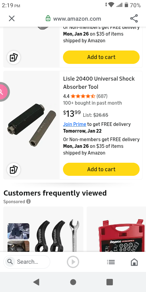

@Jay11 I found this on Amazon a few seconds ago.
I hope this helps you.
I for 1 would like to Thank you for reminding me about this tool I have talked about and have found on Amazon so I could take a screenshot of so that you would know exactly what I was talking about.
In the past I found this tool to make changing shocks a lot more convenient.

Whoa that's it! The information you provided was what I needed and I am grateful to you. Thank you!

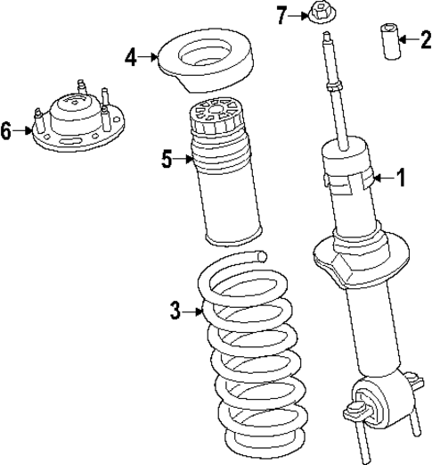

Yeah, like mentioned above Rangers don't have struts, they're just shocks with studs on the top, a strut is a much heavier duty unit that has a spring around it but the shock body also does suspension alignment duty, if you look up McPherson suspension or however it's spelled it should help explain, more often used on front wheel drive as it leaves more room for the drive axles and on unibody vehicles since they have more structure higher up.
i think almost everything is going to struts though. this is my 2024 ranger front strut
My 2019 has them in the front as well. As a result, I should probably get strut specific tools. The spring compressor I had wasn't up to the job when I was helping JohnnyO with his leveling kit. I haven't gotten around to replacing it yet.
