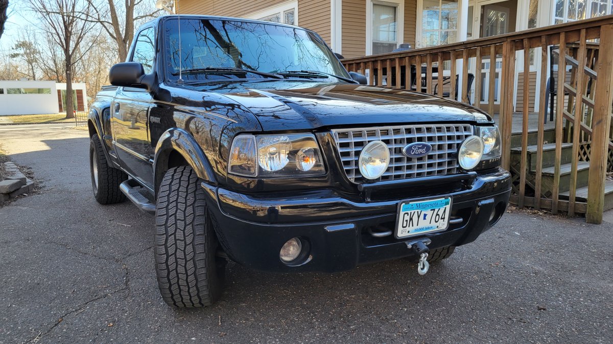

I am very pleased with Cooper All Terrain tires that are 10.4" wide. My aftermarket wheels are slightly more off set than stock , extending them beyond the front fender wells. I don't mind. I put fender flares on. The rear tires don't extend out as far. If I were to do it all over again, I just might make the rear tires another 1' wider. Someway argue that this might affect the way the tires track, but I don't think so.
We just got Cooper Discoverer AT3 tires from 4Wheelonline and very pleased with the performance so far.
