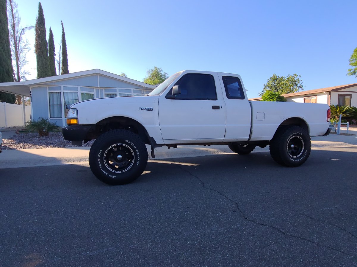

So i just put a 4" spindle , 2" shackle lift with 33" tires on my 2000 Ranger 2.5 2WD. Around town shes ok, but on the highway shes SLOW... i can barely get out of 3rd/4th gear going 55mph. I do live where the roads have inclines and declines everywhere so shes always struggled but not nearly this much.

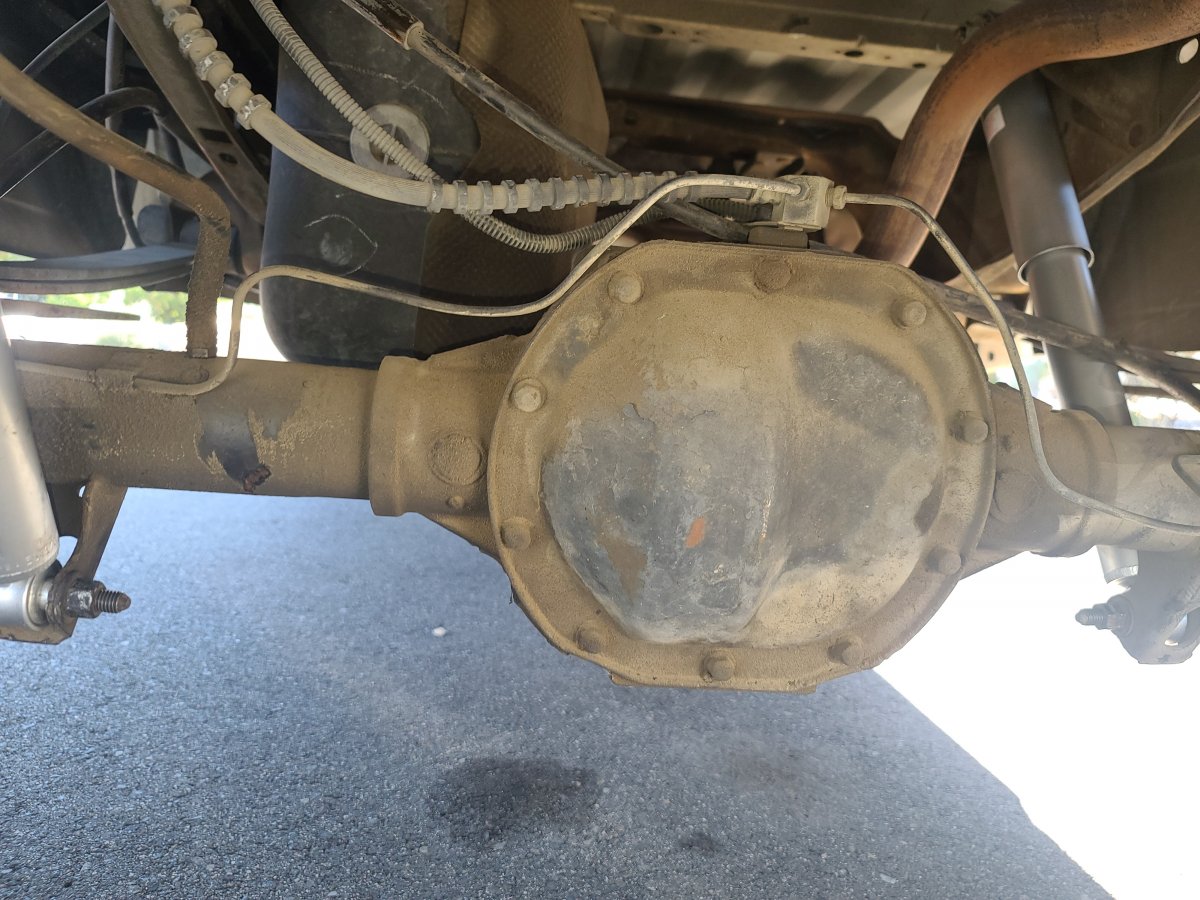

My door has code 87 which ive discovered means i have a 7.5 4.10 diff. Theres no tag on the diff so who knows. Before finding that out i read that 4.10 or 4.56 would bring her back to life. But i already have 4.10's and shes shit on the highway, would 4.56 really make that big of a difference maybe theres a better ratio? I will be mainly on the highway with mild off road, just to take the dirt bike out and go shooting. I got quoted $750 parts and labor and lets just say i cant throw money that easy right now so im trying to make sure its worth it.

You've gone up 5 inches in tire size on a motor with 117hp.
You have 4.10 gears now, the tires have effectively reduced that gear ratio to about 3.40. You would need 4.94:1 gears (those don't exist, just the equivalent ratio) just to get it back to stock overall ratio.
Since 4.94 gears don't exist you basically you need 5.13 gears, but 4.88's would probably be "OK", 4.56 will probably still leave it pretty sluggish. But even 4.56 gears require grinding to fit the stock rear so I don't even know if anything bigger is available for the 7.5" rear.
Yup. 4.88 or 5.13 gears.

Should be a tag on the axle. There is also an axle code on the sticker on the driver door jamb. Instructions in the tech library for interpreting the codes. Also a great article on the physical/visual differences between them.
Hot linked. Thank you.
Edit: Axle code 97 - SAAAAAWEEET. I can run 5:13 in the existing pumpkin. I'm a happy man. :p
97open 8.8″27504.10
