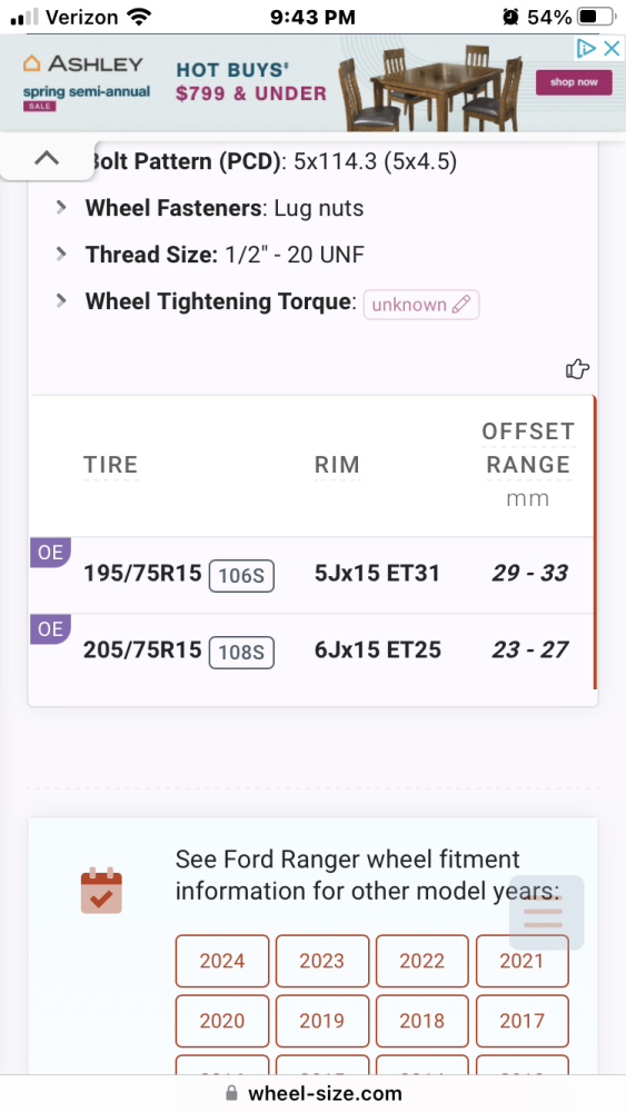

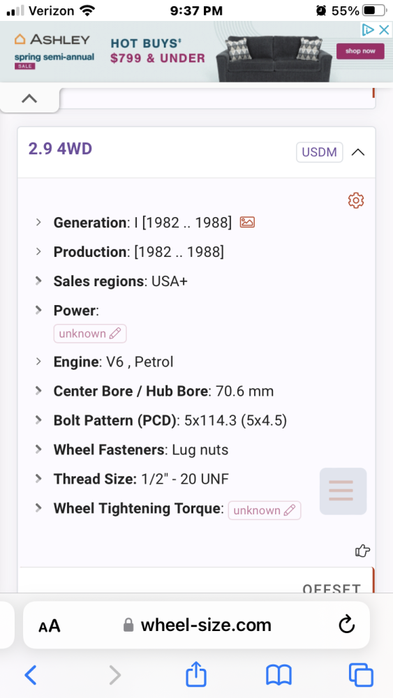

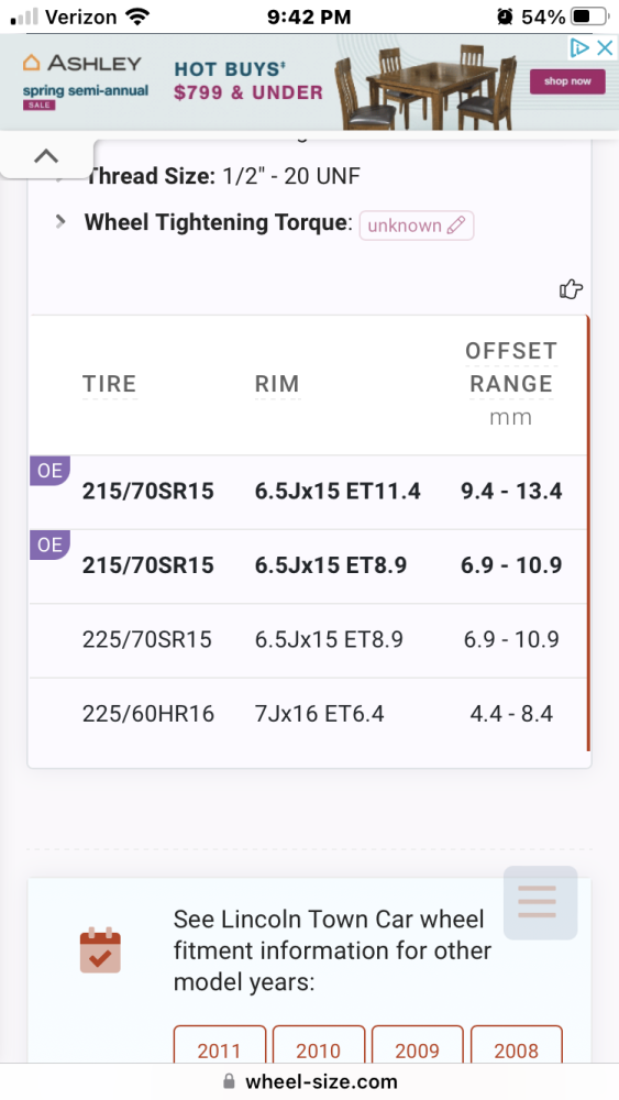

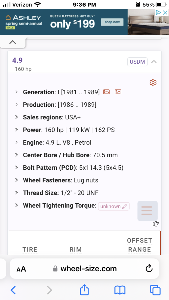

Also I need to do some research on LTD wheels. I know that they have the same lug pattern as the Ranger, but I don't know what stock wheel size is. There was an 80s LTD Crown Vic Wagon in there that has a set of factory turbine wheels (with caps, no tires) on it that appeared to be in good shape. I've always like the turbine wheels, but never see a set of the available in decent shape around here. I may get them to run on the 85 until it's time for the big brake move, or to use for trailers. I'd hate to see them go to the crusher, at around $200 for the set, I'm going to have to do some more thinking on it. These wheels, in as good or better shape.
