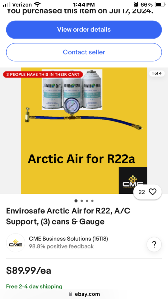

I don’t know if you’ve heard of the “arctic air R22a“. It’s propane, and you can use it to top off the house system or your car system. Propane is much more efficient than the Freon, but of course it’s flammable, so you might not want to have the whole system full of it. I’ve used it many times. I bought this kit when I tuned up my home system earlier this season.
I put one can in one system (I have two systems, up and down). All pressures came out OK, and knock on wood, they’ve been working perfect all summer. I didn’t mind buying the three cans with the little adapter, because I always have to top off the F250 and one of the Lincoln’s a little bit.

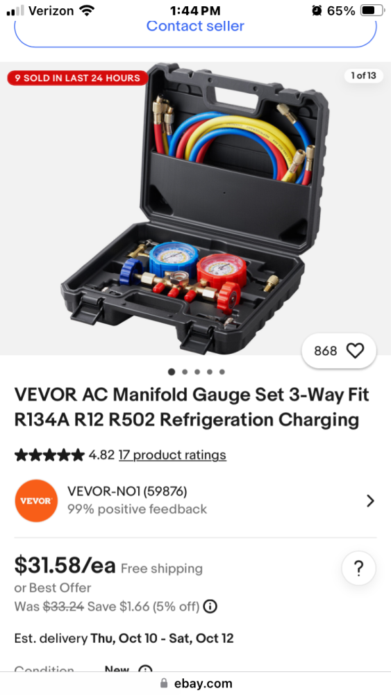

I also recently bought a cheap gauge set with the adapters so I can hook it up to the house as well as the car. It was only $35. I’m sure you saw my post when I fixed the AC on the Road Ranger, and the 35 bucks was some of the best money I spent in a year.
