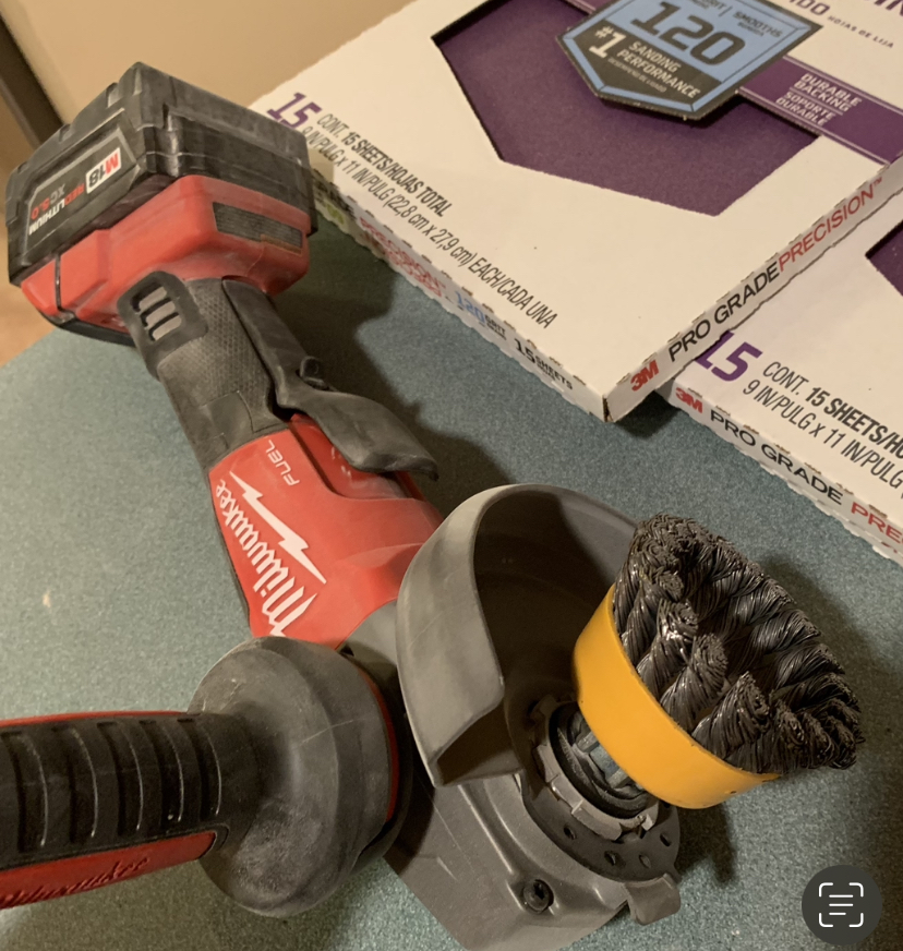

Has anyone else ever had to use a wire wheel on an angle grinder to take the paint off an interior wall?? The previous owners painted the walls with a sand textured paint that can’t be sanded. I burns through 2 sheets of 80 grit sandpaper in a spot less then 1 square foot trying to remove it.
The only thing I’ve found that will take it off reasonably quickly is an angle grinder with a wire wheel cup. I’m literally shooting sparks off a sheet rock wall trying to remove this stuff.

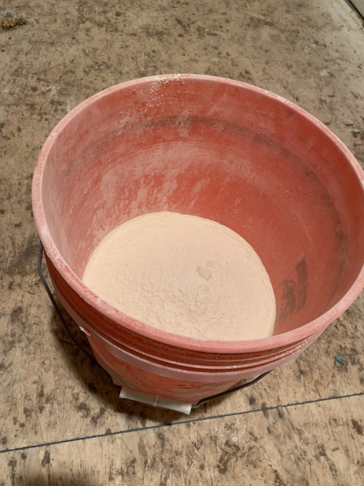

I’ve already sanded the textured walls down in 2 rooms, what’s one more?!?! Here’s a bucket of sanding dust for you:
The other 2 rooms were easy, the texture on those walls was just spackle. This last one is actually sand mixed in with the paint. (For better traction on the walls?)

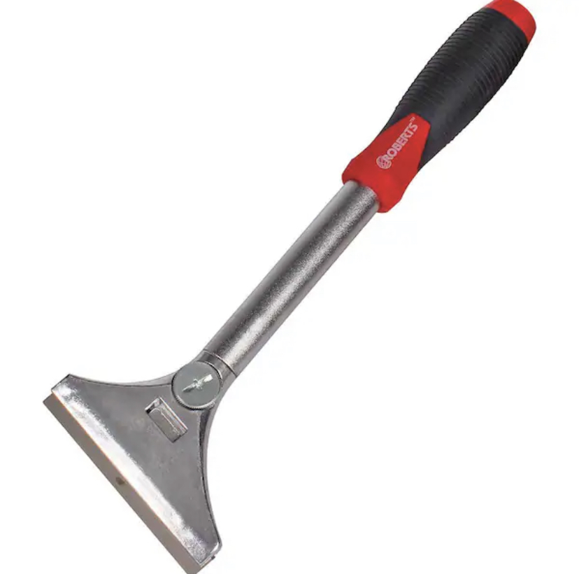

Tried it damp. Tried it wetter than damp. Tried it wet. Tried a wall scraper:

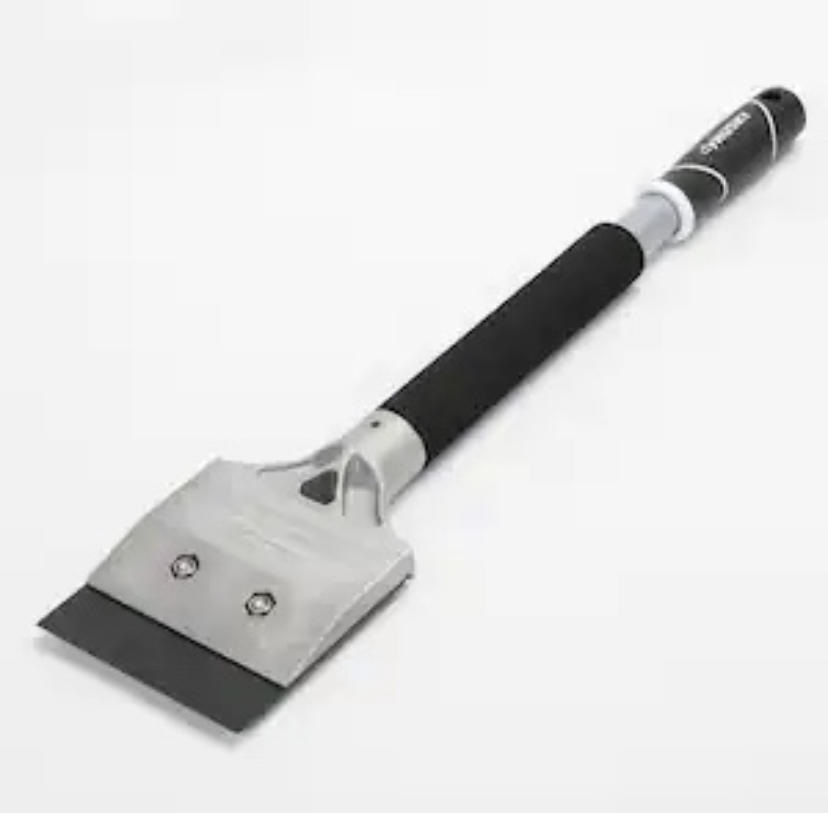

That didn’t work. Then I tried a heavy duty floor scraper with a blade that could do some damage:
That didn’t work.
But an 80 grit flap disk… that worked. It left the wall a little too damaged.
The best I’ve come up with has been the wire wheel cup on an angle grinder. That knocks the sand off the wall, then I can smooth it out with my palm sander and a drywall screen.
I don’t have all my tools here, so I’m limited in what I can try.
