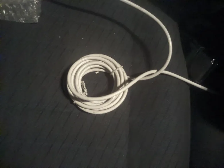

I picked up a new antenna on Marketplace today. My old one was a magnetic center loaded Cobra that was missing the stainless whip part, so it wasn't the most useful for reception and I didn't want to risk transmitting on it. Driving back across Denver in traffic and then sitting in a parking that's 3-4 miles from about a 6 mile stretch of I-70 I was never able to get anyone to break squelch on my new antenna. Granted there's a mesa between the parking lot and most of that stretch, but no one responded on 19 at all and with the gain all the way up and the squelch all the way down I could only occasionally get someone to come in faintly on 6 or 11. With the old antenna I could hear a group talking in a truck stop a half a mile away so I know the radio works, and the antenna is a magnetic Wilson 1000 that the seller said once reached a guy in Georgia.

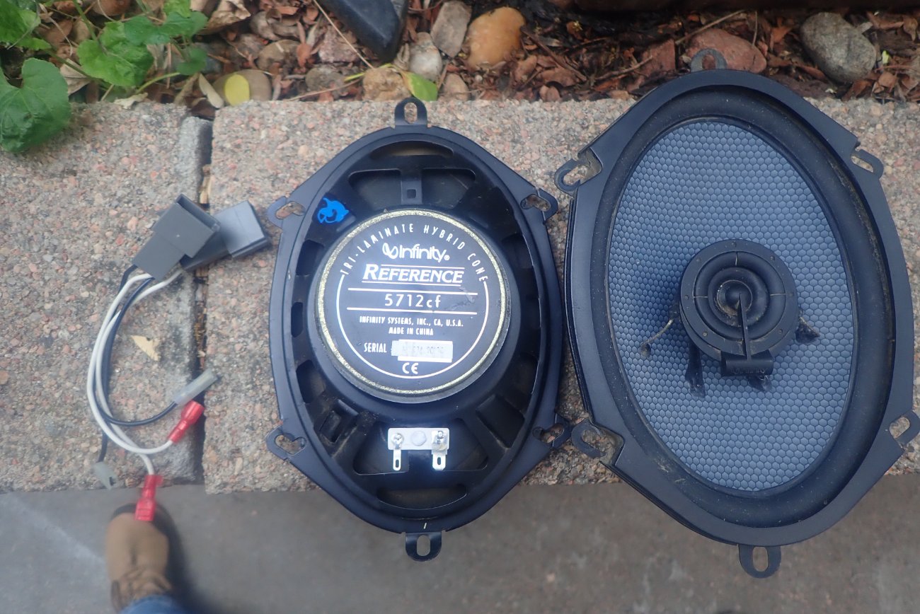

Anyway, I went to the junkyard Monday for the 40% off sale. One of my finds was a pair of aftermarket speakers from the rear of a regular cab 1994 F-250 that had the wiring adaptors.

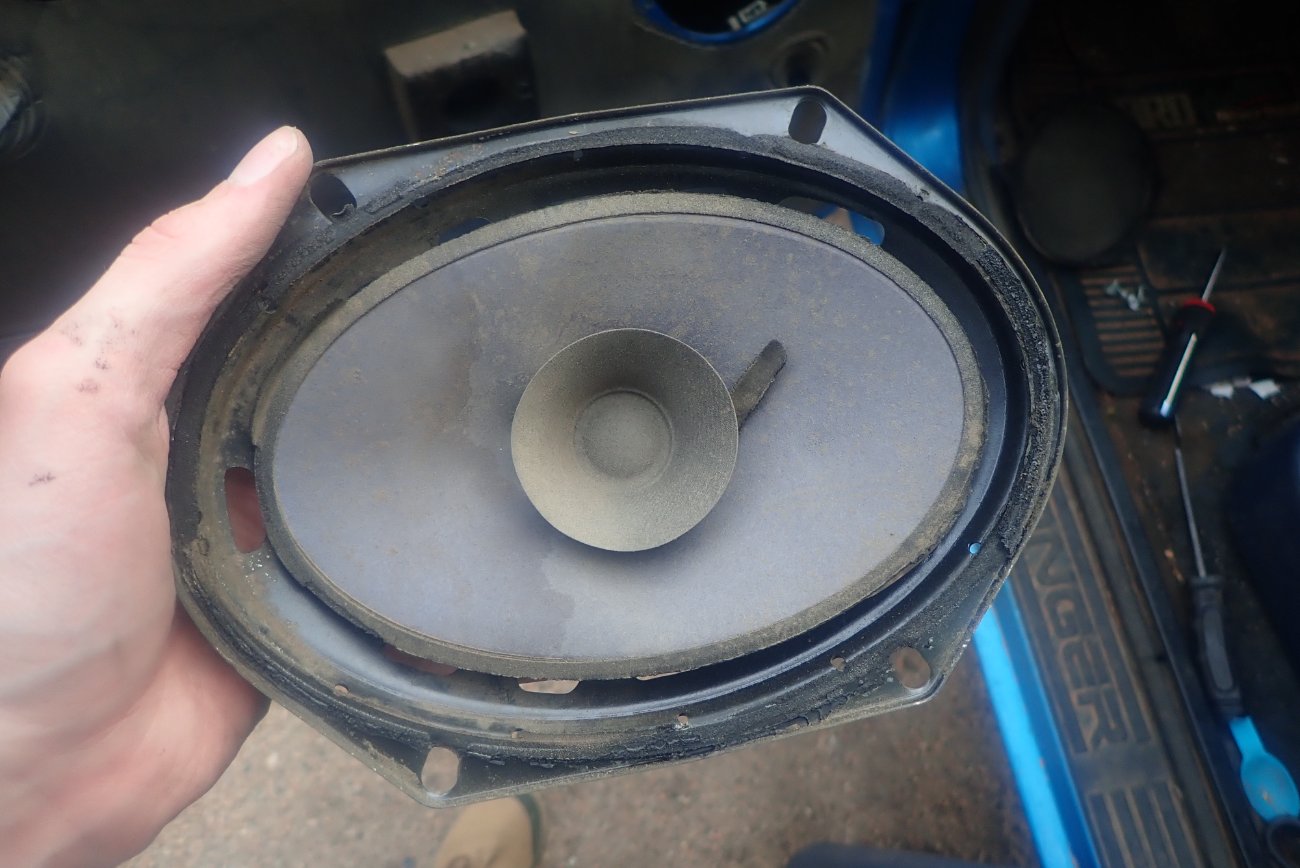

I figured out why my speakers sounded bad. Foam? What's that? View attachment 143765

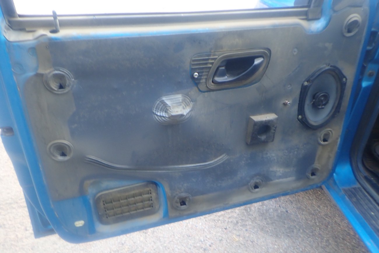

Here is one of the new speakers plus all of the accumulated dirt behind the door panel. Most of the plastic tabs were broken off on the passenger side, but I'm not convinced that the driver's side had ever been off.
I had to glue up the speaker that I put on the passenger side because the foam was partially separated. I did that with one of the subwoofers on the towers hooked to my apartment's TVs, radio, and Bluetooth sound system and it's still holding. I used some random wood glue that was laying around but white Elmer's is supposed to work too.

Much better knowledge than mine on this website regarding the drivetrain stuff, but a thought on the CB radio/speaker stuff.
CB: I don’t remember what Radio you have, and this is not a criticism, but even a cheap radio with a cheap antenna should be able to broadcast back-and-forth easily without adjusting any of the gain or other buttons. Put them all top dead center in the middle, and the radio should work. The more expensive radios and antennas and little details on the set up and connections might make work better, but it should still work.
Check the continuity of the antenna center lead with an ohm meter. Do the same thing with the shield, both end to end. Then check from one to the other. Obviously, there should be zero resistance end to end, and infinite resistance from the lead to the shield.
If the antenna comes apart, just open it up and check the connections. If it’s a magnetic mount with a felt or rubber bottom, using a razor blade and a pick, you can carefully pull off that protector and see all the stuff underneath. Check it, loosen it & retighten it (for good contact) and then just put the pad back on with a little E 6000 or Goop. Specifically those products, because they remain soft and pliable, and you can pull the whatever off, literally pull off the glue off (no scraping) and redo it if you have to.
Are you calibrating the radio on channel 1, channel 40 (or 23 on an old radio), and also 20 (the middle, 11 on an old radio)? Try that, ride around a little bit, and then just double check your settings again without adjusting anything. Are those settings wandering off what you set them at after just a little bit of use? Internal problem.
Do you have your antenna wire looped up in a circle anywhere? That creates “coil” that could interfere with incoming & outgoing signals. If you have extra wire, string it back-and-forth or in a star pattern or something like that in an irregular shape under the carpet or behind a panel, never coil it.
And the last thing, maybe the first thing & the best thing, is find a buddy with a radio, and play with him/her back-and-forth. I would start by putting their radio into your truck with your antenna and vice versa and see if the problem transfers to their truck, and see if their radio works in your truck. If your antenna is portable, sit on the roof of their truck and plug it in their radio and check the transmit light/signal on the radio and see if it works with your antenna. That should tell you pretty quickly if it’s the radio or the antenna.
Also, you can buy RadioShack/TRS/Midland/whatever name brand cheap radios that have been tested and work on eBay all day long for 20 or $30. Pick one up and see if that fixes the problem, or you can keep swapping it back-and-forth until you identify the problem, and then you can turn around and sell it again for 20 or $30.
On the speakers, not rocket science, a cheap new speaker will work better than a premium damaged speaker that’s been repaired every time. And/or, there’s a million speakers in the scrapyard, hunt around till you find one that’s clean and undamaged. A much newer model Ford speaker will probably fit if it’s about the same size, without modifying your door. Bring the ohm meter and just make sure it matches the ohms on your old speaker, and then when you’re putting it in, be careful that you have the positive and negative connected properly. There’s nothing more enjoyable and calming than good quality sound, and there’s nothing more annoying than a speaker that buzzes or cuts in and out, especially after you spent a bunch of time on it. If you normally lean to the 51% side of should I run over this SOB or hit them with a tire iron, good speakers can calm that urge. 😉
