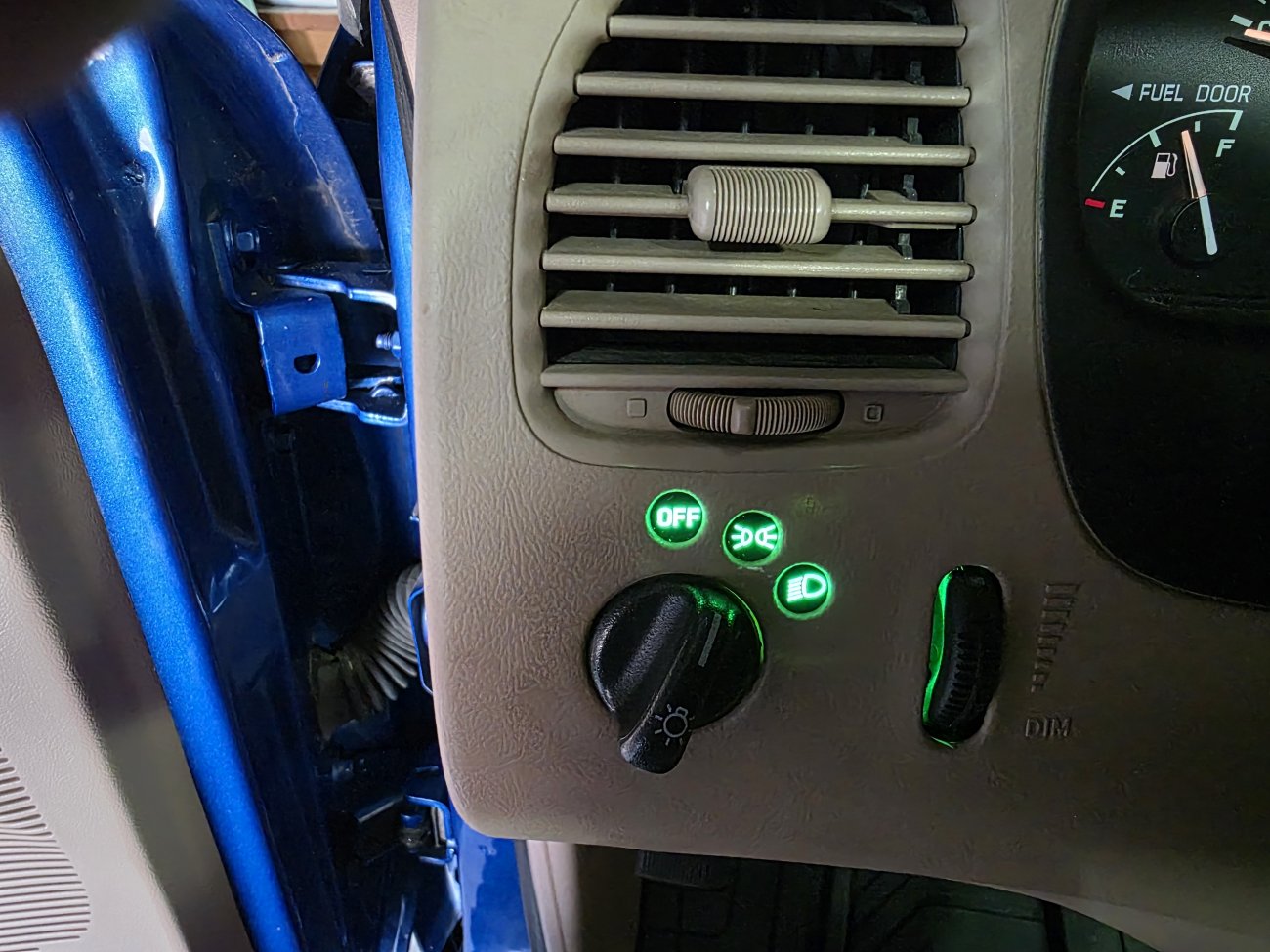

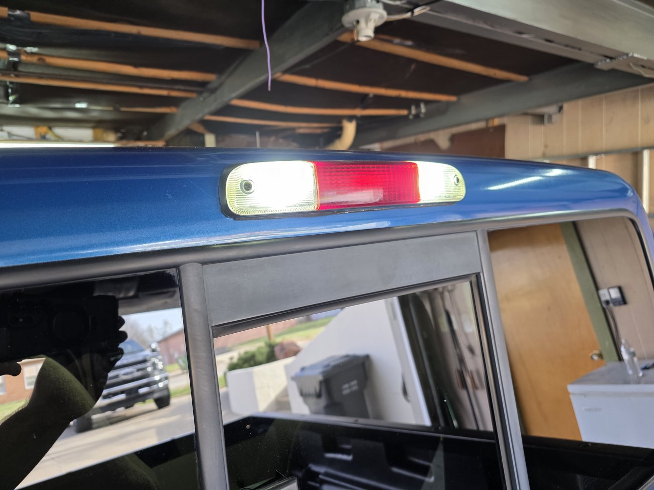

Drained rear diff yesterday and prepped the housing and cover. Lubelocker came today, got it all back together after work today. Also did the Buggman mods headlight switch in green. Put leds in the dome light locations, plus leds in the cargo lamps and a red zevo led in the third brake light. First pictures also after the interior and exterior full detail.

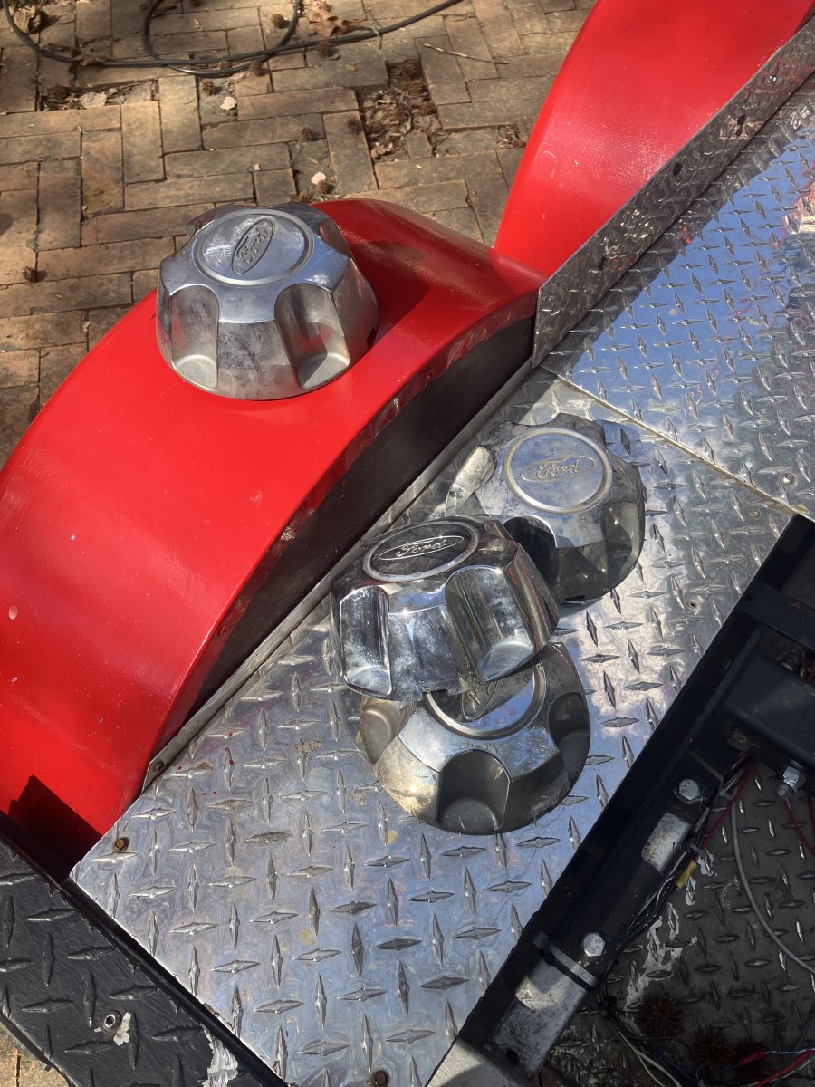

I picked up 4 more center caps, the ones I like for the Road Ranger project, for $25 total.
I think this gives me two extras above what I have planned and what I have now for trailers using the bullet hole wheels.

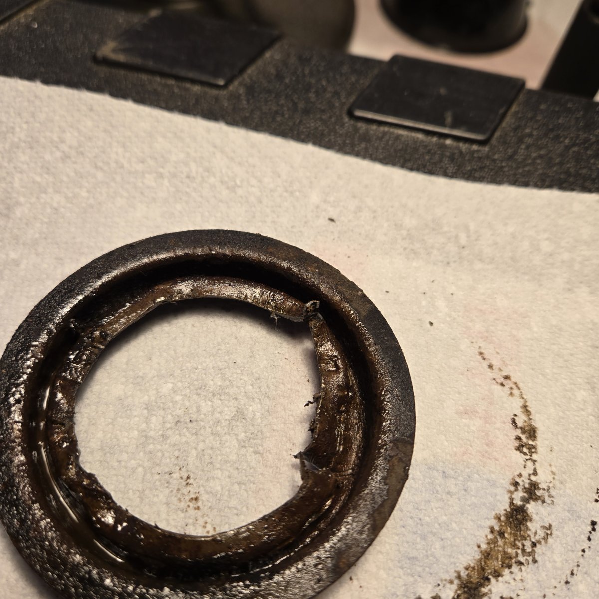

Got my intermediate axle into the cv axle. Tracked down a CV axle seal to replace the old one. Attempted to remove the seal. The rubber portion came out but the steel flange remained. I had to mangle and muscle that thing out and I ended up gouging the inside of the axle tube where the seal will sit. I have a little metal burr sticking up where the seal is supposed to seat. So tomorrow I'll be sanding that down. I read on another forum to sand it down and then put rtv over it.
