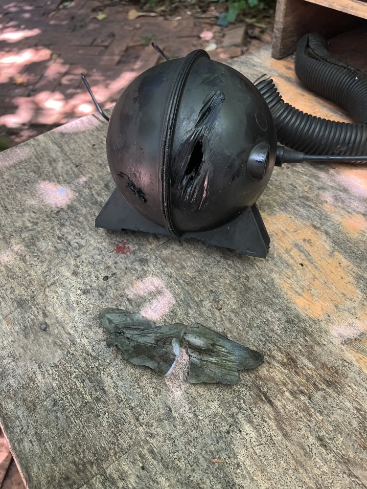

Heater control valve came in, so I tackled that. And with all those hoses out of the way, it made it easier to troubleshoot the vacuum line to the HVAC control. I have a/c, but it only blows on the windshield. When I first charged the system, it would work right until I stepped on the gas hard and then blow on the windshield.
I got all the hoses out of the way, back to that little sphere accumulator tank. It all looked OK from the top. Vacuum line went in the front, vacuum line to the HVAC system out the other side of the front, and the hole on the back was plugged. I couldn’t find anything there so I proceeded with the heater hose. I ended up taking that vacuum tank out for better access to that lower heater hose

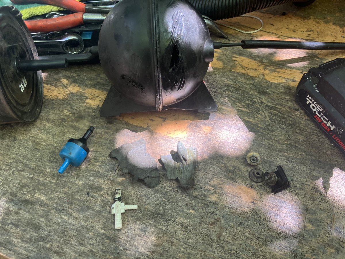

You guys know this stuff a whole lot better than me. This is what I found when I flipped it over.

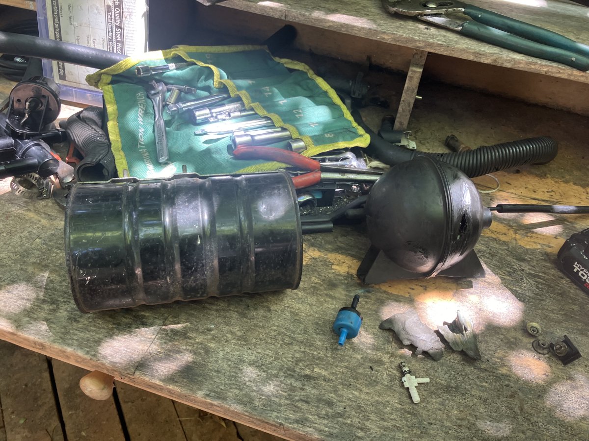

You couldn’t see that big gray plug from the top. It seems to fit in the hole perfectly, but when I was taking it out to check it, I snapped it in half. I looked all over the Internet, but I couldn’t find another one, so I went into the shed of miracles and got one of the soup can vacuum accumulators from my square-body 80s Lincolns.
I was thinking of putting one in anyway, because it’s three times the size of that little sphere. If I had a little vacuum leak, that might make up for a little leak.
It wouldn’t plumb up the same way, so I dug in the shed a little more, and I found a little tiny T, and a check valve. I had to drill a second hole in the fender well to mount it, but it fits like it was made for it. During the driveway test, the AC seems to work perfectly, but I haven’t had it on the road yet.

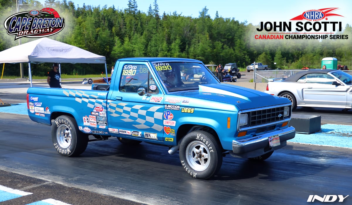

Our track photographer just sent me this one of our Thursday night Test & Tune session. Qualified #4 on Sunday, put out an Alcohol Dragster
in round one but gave away the stripe to a big inch Roadster in round two by .0003. Starting to get the tuning bugs worked out though so it wasn't a total loss....
.View attachment 115381
way way too cool!!!

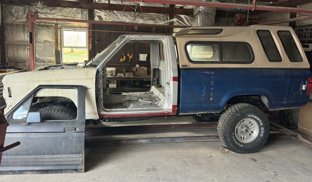

Set the Shadow camper shell on it yesterday evening. My favorite feature is the sliding glass on my back window and the shell! With the shell it’s taller than my F250 and it barely clears the 83” height limit at crew car wash so this ol girl will be a hand washer. Got driveshafts coming soon - easy does it.
that is the kind of shell i wish i could find for my truck. i want the taller top so i can put my bicycle in the back
Yes, it will be handy - I'm sure you fit a small four wheeler in it facing it backwards. I found it for $100 on craigslist in St. Louis. Glass and seals on the shell are in good condition but I will have to replace the cylinders on the rear lift window.

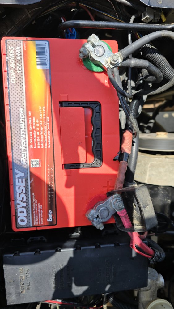

Installed the new battery. Started it up and let it run for a while. Then topped off the recently filled power steering reservoir and engine oil.
The wrap-around window on the front of that cap is nearly too awesome to be understood. Nice find!
