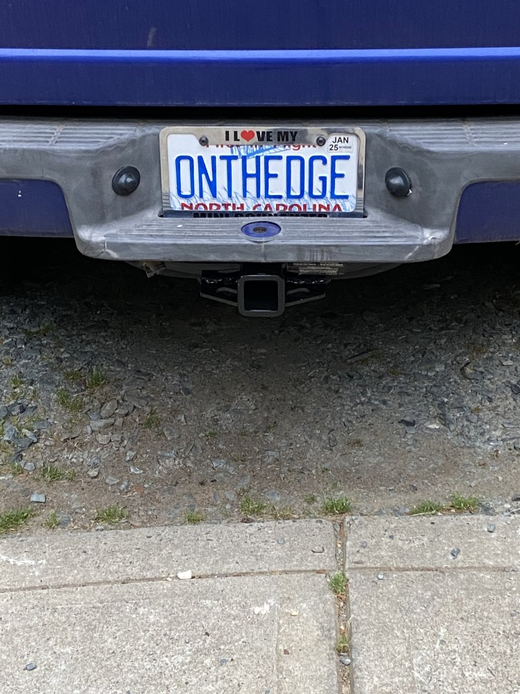

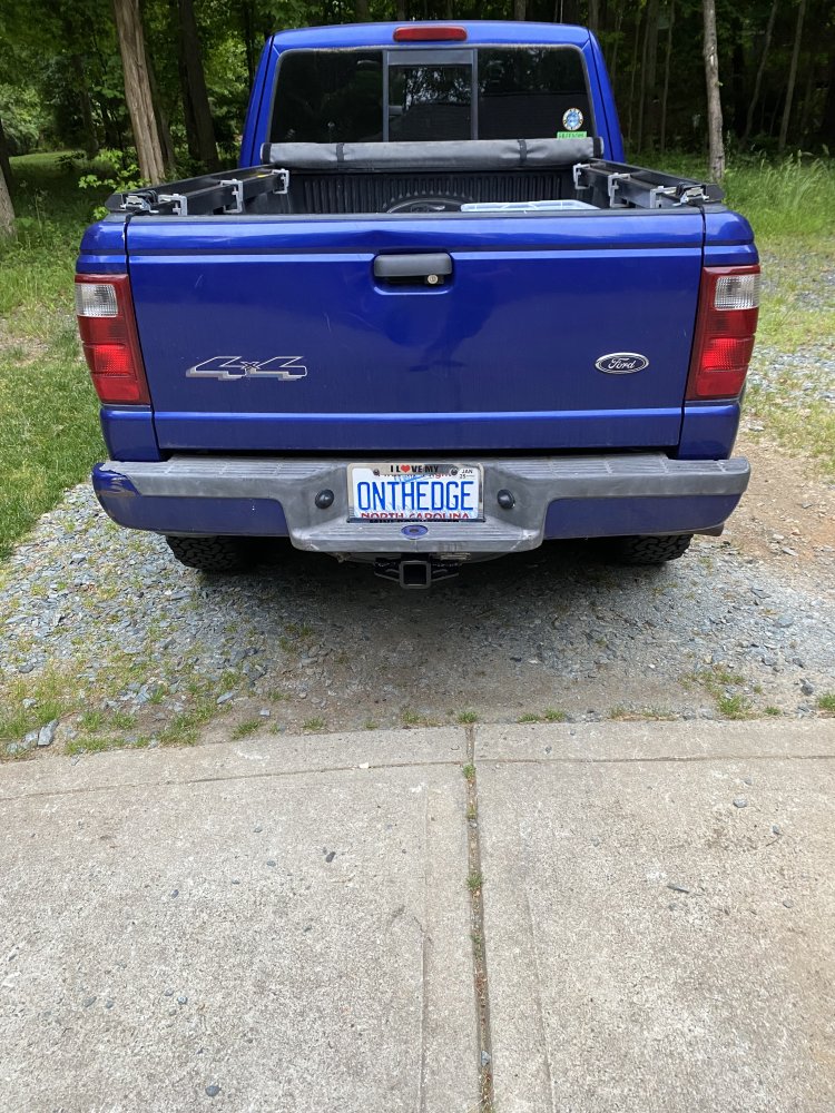

Put the hitch on last night, got pics of it today.
I went with the curt round tube, as the square tube is too much of an eyesore for me. I like the more hidden look of the round tube. View attachment 110457View attachment 110458
My Ranger came with a round tube hitch from Ford. The hitch was stolen off the truck. I bought a Hidden Hitch, same as Curt for the ext. cab 4x4 with the dual overhead cam engine. It came stamped with the Ford data on it. It turned out to be a Ford hitch. Hidden Hitch provided Ford with hitches back in the 90s and early 2000s.

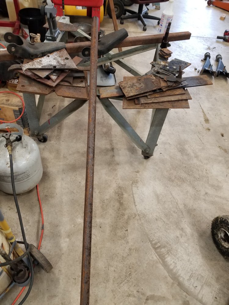

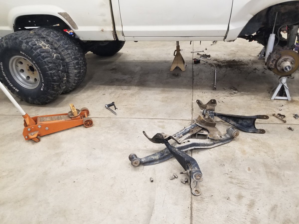

Here's the current pile of spare parts (just noticed the frame brackets were still in in that picture), and in the second pic to the untrained eye it might not look like a transmission crossmember and extended radius arms but it sure will be...

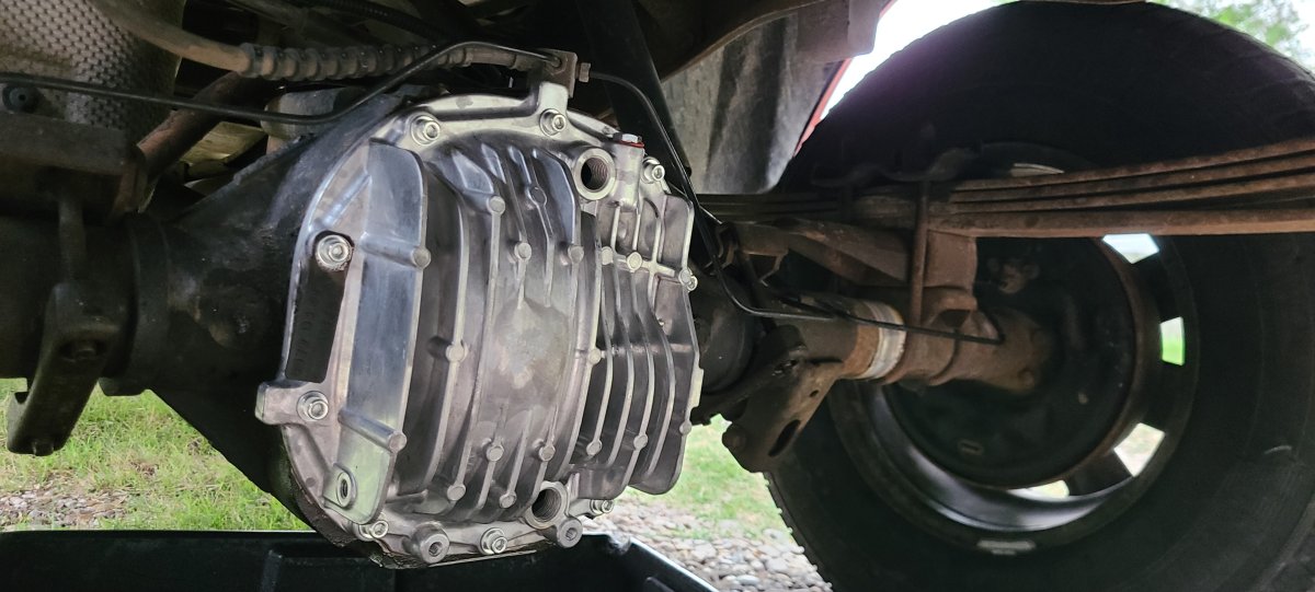

Motorsport clone diff cover is on. I did some machining (i have a grinder and am not scared to use it) on the internal fin that the tone ring kept touching. And its a go.
