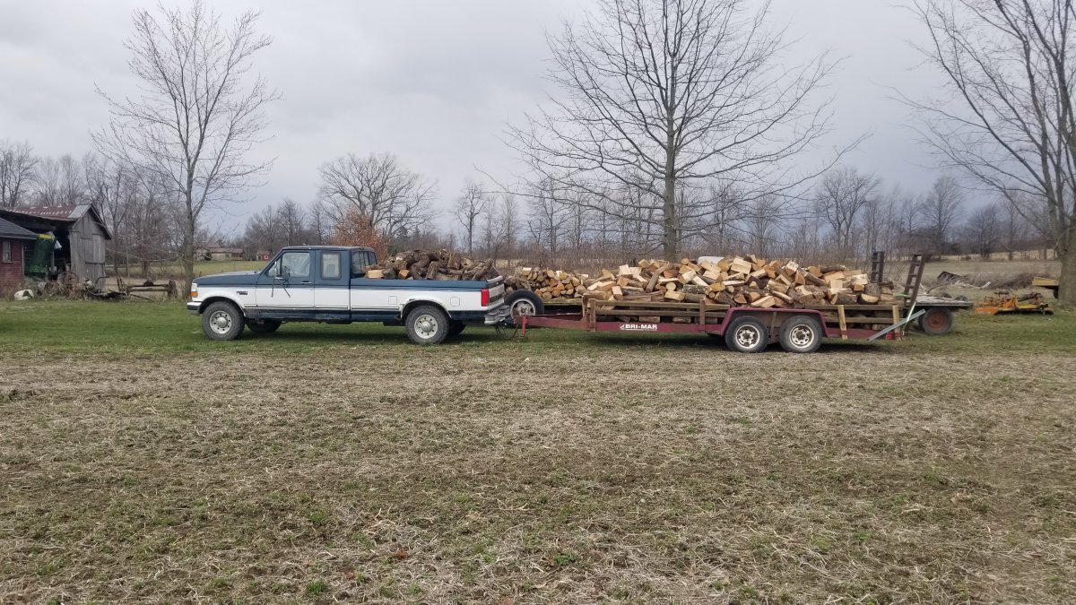

This load was stupid heavy. First load i hauled in 10 years of ownership of this truck i thought i mighta overdid it. But she got er did. The 460 didnt groan nearly as much as everything else
Disclaimer....i went 4 miles on no traveled dirt roads.
That looks like 8-9k pounds to me with the ~2-3 cord of wood (assuming not oak) and trailer, it's up there

the trailers 2500lbs...plus whatever i had in the bed.
Ive had 13-13500 behind it before and it didnt feel this bad lol. Of course that was a mini excavator on a gooseneck with properly functioning trailer brakes.
Either way i had my fun and next time i dont think ill load it quite so heavy lol

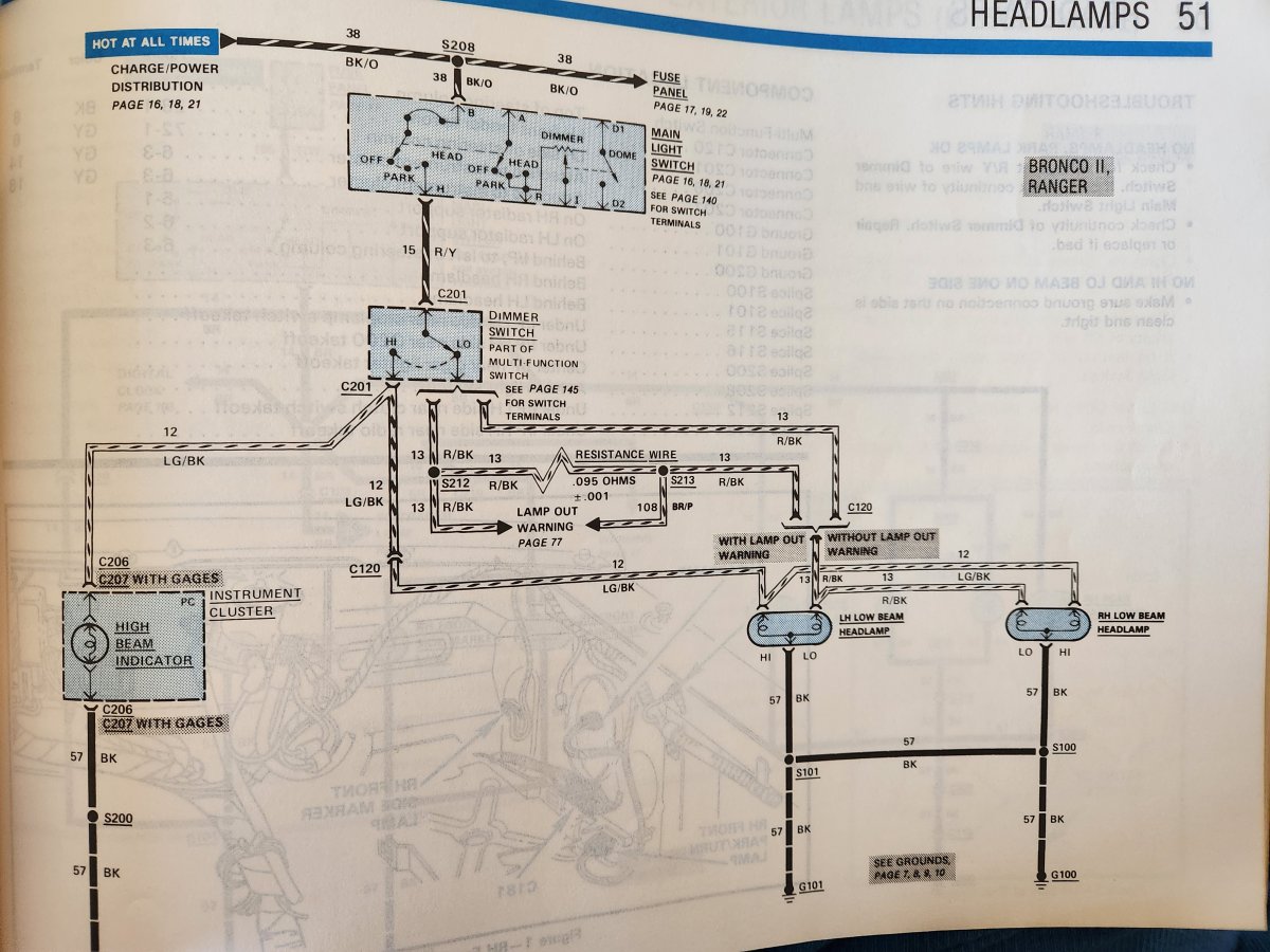

This is from my 86 EVTM... basically the same I believe...
No relays... dimmer switch to headlamps.
You will need to put a probe on that circuit 12 to see if there is actually power there when you want high beams. My guess, as Cam has already stated, is that the multifunction switch is bad.
