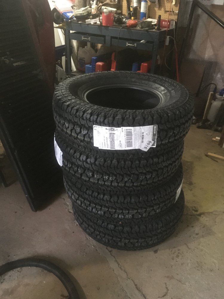

new sneakers for the old girl
Kumho AT51's

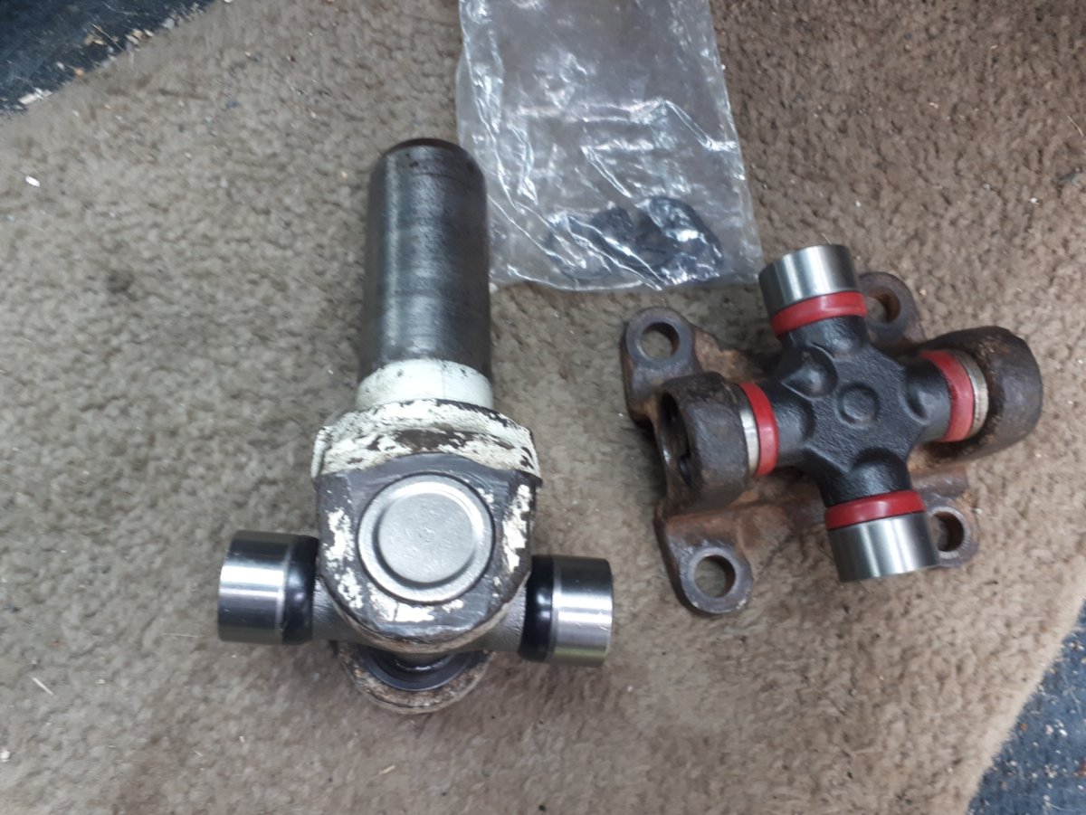

Final piece of the two piece to one piece driveshaft swap. Hybrid U-joint was needed to fit the TH350 yoke to the Ranger driveshaft. Ranger shaft has external clips and the TH350 yoke has inside ones.
