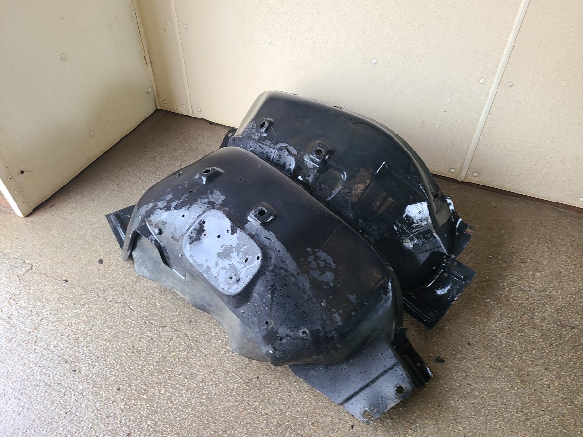

Took me 20+ years but I finally got the the dang inner fenders washed.
What is this “washing your fender liners” you speak of? Doesn’t that break some kind of rule or guideline?
Don't knock it until you try it. :secret:

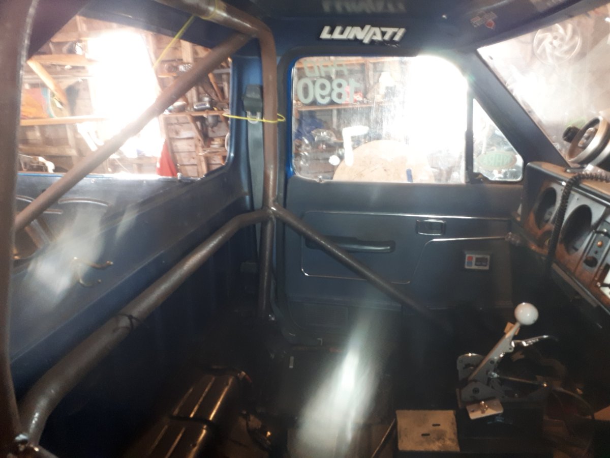

Almost done with this patience testing roll bar install. Just have to fill in around where the bars go through the floor and we can get some paint on it all. Sorry about the glare off the garage windows....

Where are the shoulder belts going to be anchored? In my research I decided that having the anchor below the top of the shoulder was not good for the spine. I ended up putting a 1" bar across at shoulder height and using it to change the direction of the belt so the belt was perpendicular to my spine before bending down to anchor on the roll bar.
The lap belt is what is supposed to hold the body down. The shoulder belt is supposed to hold you back, not down. Just info for you and anyone else building cages to think about...

Going by the book on this one. As a former Tech Inspector I've got to make sure I'm completely within the rules.
NHRA/SFI seatbelt rules.

The diagram you posted confirms what I said, with a variation of 10° to 20° from horizontal. The seat back is at 25°. So the shoulder belt is actually at 95° or more relative to your spine. In your pic of your cage, where are your shoulders going to be? Compared to the horizontal bar... it may be optical illusion, but it looks to me that the bar is significantly below your shoulders, so would mean the belt would be more than 10° to 20° from horizontal (much less than 90 relative to the spine).
At least that's the way I'm reading your links rules...
At the end of the day, it's your ride and you have to feel like you did the right things to keep yourself safe. I know I spent many hours researching this subject so I felt confident in my safety when I was racing.
I rolled my truck at a not high speed and was really surprised at how much give there is in a 5-point harness. I thought I had my harness as tight as it would go. It felt like I moved at least 2-3 inches in all directions.
