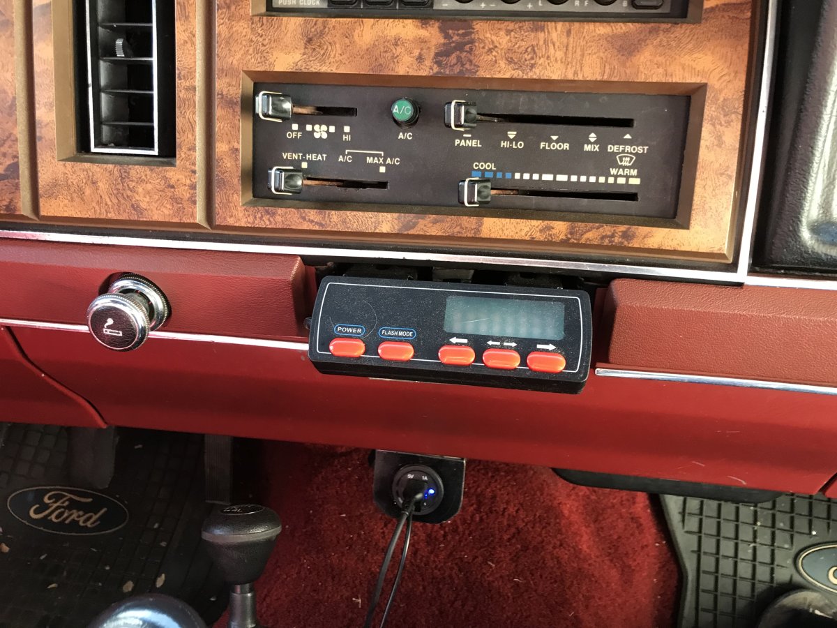

The traffic alert/annunciator bar is one of the rare things that I actually bought brand new, I think it was about $140 on eBay with the light-display controller. If you guys ever get a traffic alert bar, make sure you get it with the light display controller. Otherwise it’s a pain to figure out what pattern it’s flashing which can also be dangerous if you’re stuck in the road.
The cab lights are the triple LED in a smoke housing. I had chrome and amber, but it clashed with the flag logo too much.
I took the face off the ashtray, and used a little piece of scrap aluminum to make a bracket and attach the annunciator controller. That way it’s at my fingertips just above the shift Knob. I also added a dual USB outlet between the shifters below the dash so I didn’t have all those wires sticking out of the cigarette lighter hole.

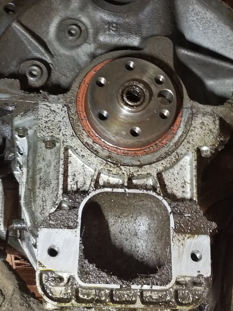

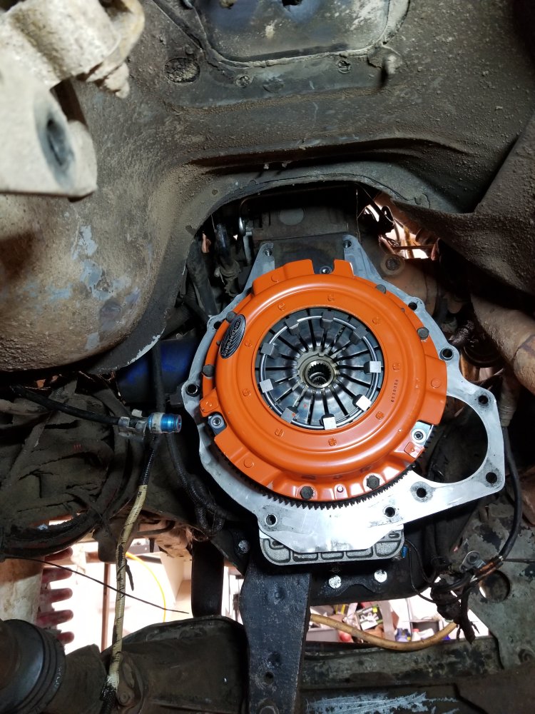

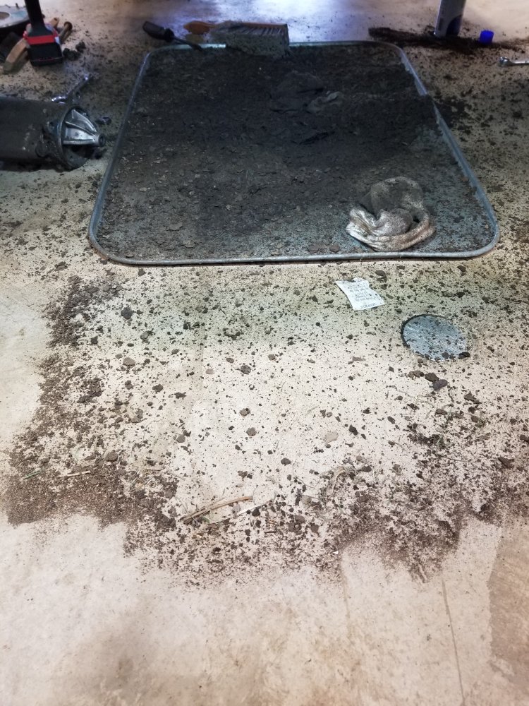

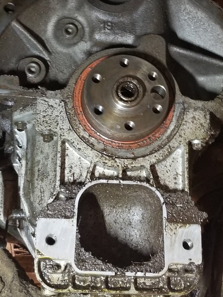

Here's some shots from last weekend... the shot of the back of the oil pan area is why I was procrastinating so dang long getting anywhere... the metal pan might not show everything but there's like 5lb of dirt and oil (along with 3 sock rags) I scraped off of stuff (and still got covered when I touched ANYTHING), then there's the shiny new Centerforce clutch, then a poser pic by my tiny pond after my test drive... Oh, and if you look closely you can see that a couple of the spot welds on the pinch weld in the trans tunnel have failed, I decided that's a project for another time :)
