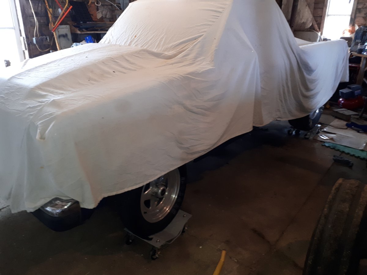

CalTracs install finally complete - Excess U-bolt and center bolt threads cut off, U-bolts torqued to 100 ft/lb, wheels back on, sitting on the wheel dollies and snug and warm under it's blankie. Roll bar is next on the "to do" list.

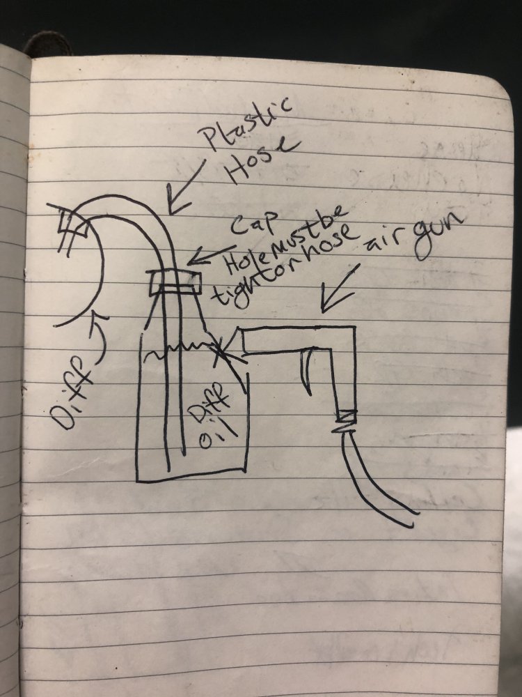

74265
For next time. Make sure to use a very low psi. 2/5psi.
