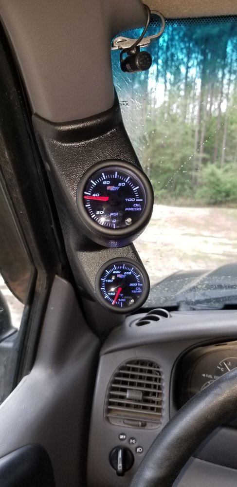

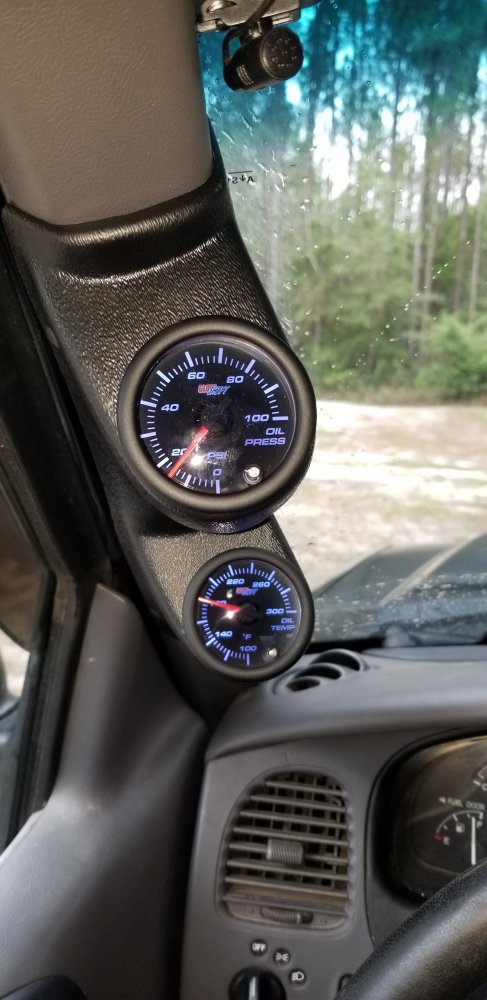

Installed the sandwich plate and gauges yesterday. 60psi at cold idle, but drops pretty quickly as it warms up. 20 psi at 150° EOT at idle. 16 psi 180° EOT at idle. I'm beginning to think the stock switch may be correct and it's dropping below 7 psi after driving awhile and stopping at a red light or something. We'll see later today or tomorrow after a good long drive.

Installed the sandwich plate and gauges yesterday. 60psi at cold idle, but drops pretty quickly as it warms up. 20 psi at 150° EOT at idle. 16 psi 180° EOT at idle. I'm beginning top think the stock switch may be correct and it's dropping below 7 psi after driving awhile and stopping at a red light or something. We'll see later today or tomorrow after a good looking drive.
View attachment 61037View attachment 61038
Mind me asking what brand guage pod that is? I've been looking for one that will fit the ranger pillar but have only seen "universal" ones.
I see you got the glow shift a pillar pod too...
My truck does the same oil pressure wise on start up.... but it hold 20 psi on a hot idle.

Fits pretty good, I'd say. Decided to leave it black instead of trying to color match 20 year old trim, plus I've got the black radio bezel and door trim.
I put brand new Melling high volume oil pump in it when I rebuilt it about 20k ago. Beginning to question that, though it does seem to hold good oil pressure above 1000 rpm. At 750, not so much. Probably going to 10w-40 on the next oil change. Those numbers are with a fresh change of Mobil 1 5w-30.
