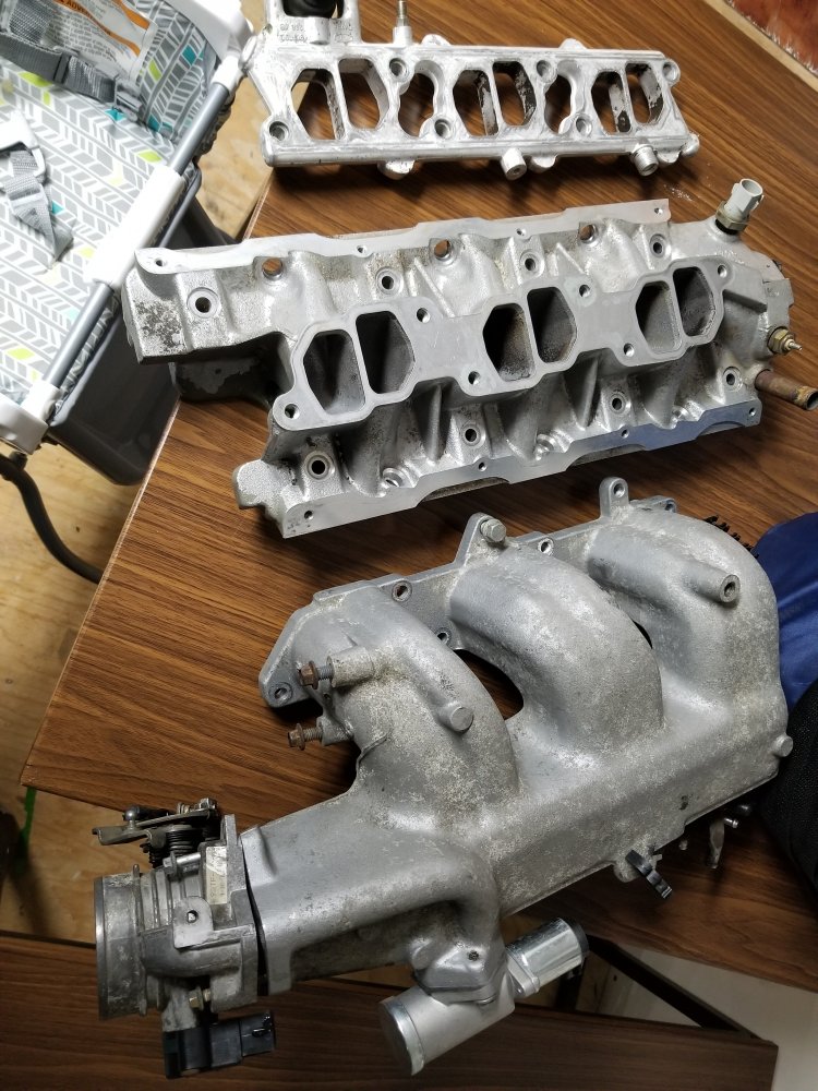

Well it wasnt to my ranger, but for the old ranger. I picked up the intake gasket set, and got the intake pulled in the 93 exp. I bought to 4.0 swap my ranger, plenum gaskets were obviously shot, however manifold bolts were nice and tight, pulled it anyway cuz i was there and bought the gasket might as well do it. Upon inspection is was fairly degraded, but im not sure the lower intake was leaking, glad i planned to do it anyway though.

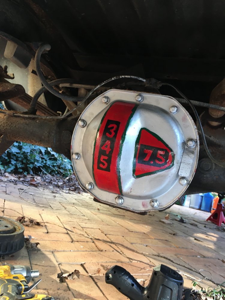

It almost hit 60 today, so I pulled the 87 4wd axle & changed the bearing and seal. I’d never done that before. I watched the video 3 times and was a nervous Nellie. It took 15 minutes! Refilled it and checked the T-case (was over filled) and front diff (took a pint). The rear gears all looked like new, no visible wear, Odom says 312,000. I had a little fun with the rear cover (gasket and RTV), so I don’t have to decode the little tag next time.

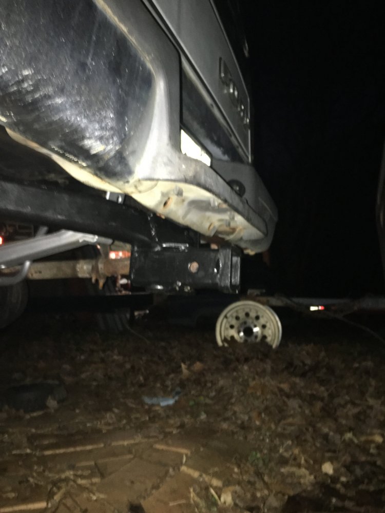

I also put on the pullapart spare tire hanger. Had to modify the tail pipe an inch with a 24” pipe wrench, but it all fit great.

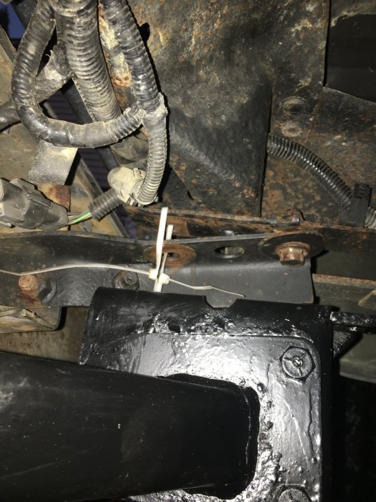

Then I tackled the PAP receiver. Man, I’m too fat and old for this crap, but I love it. I did an old trick where you pull the bumper bolts one by one, and put a loose zip tie through the holes so you never actually drop the bumper much. Then you put the receiver up and replace the zip ties through the receiver one by one, so both are hanging close. Then I pull it up with 1/4-20 bolt in one hole so I can put the real bolt in the other. I screwed up and forgot to get longer bolts but I still have it together. I’ll swap bolts tomorrow & I still have to drill and bolt the 3rd hole on each side.

Hey if you don't mind me asking, what type of rear axle is that and what's the gear ratio?

Well i used her to make a dump run, than spent several hours cleaning up the 4.0 intake parts. Ohmd out the injectors 4 at 19 ohms and 2 at 18 ohms. I bench tested and they all click, i still need to make an adaptor to test fire them with carb cleaner. Should i be ok with the difference in resistance, should i use them on paird cylinders, or should it not make a difference. Than the most important part should i paint lol.

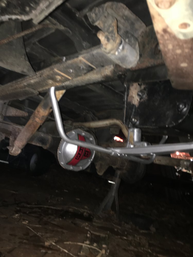

I finished up the bumper, trailer hitch and spare carrier except wiring. Bumper is low on one side a hair, I’ll shim it. I finished replacing the brake lines on the 87 4WD, easier than I thought it would be. I bled it all successfully with a HF vacuum bleeder, worked great, and then I goofed and stepped on the brakes for a feel before I put the rear drums on. Popped open the cylinder on the R rear, & then couldn’t get that bled when I got it back together. I think it’s called “snatching defeat out of the jaws of victory!” Redhead will step on the brakes for me, but I’ll hear about it for a week or two...

So, when I was sweating in bed at 5am thinking about it, I had an epiphany! I suspected the HF vacuum bleeder wasn’t working cuz air was leaking in past the bleeder screw threads. So, today I cleaned up the bleeder valve and put a 1” x 1/2” piece of Teflon tape on the threads and tried again. Sweet success and the redhead will never know!

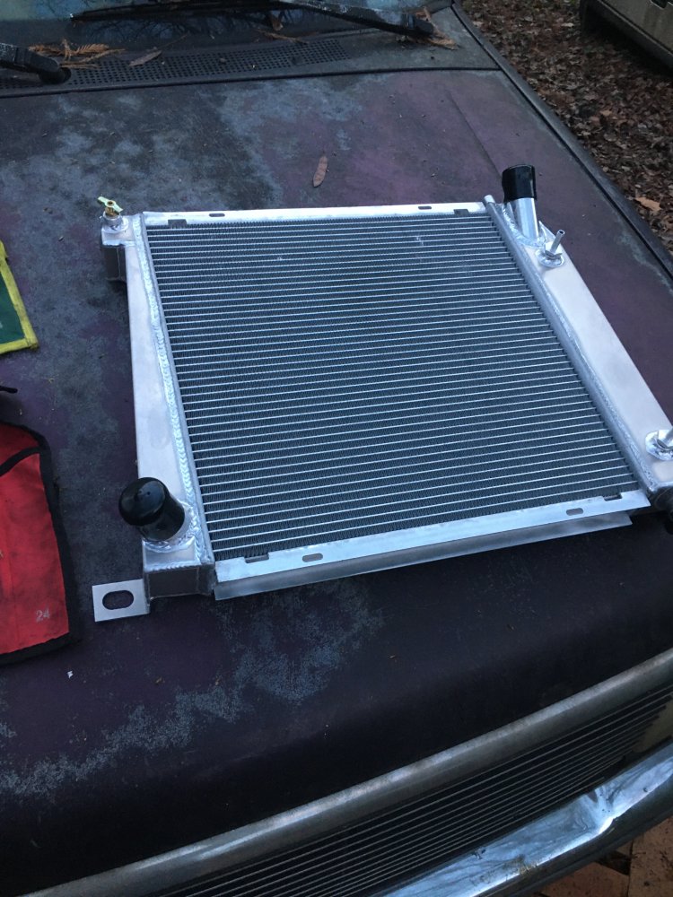

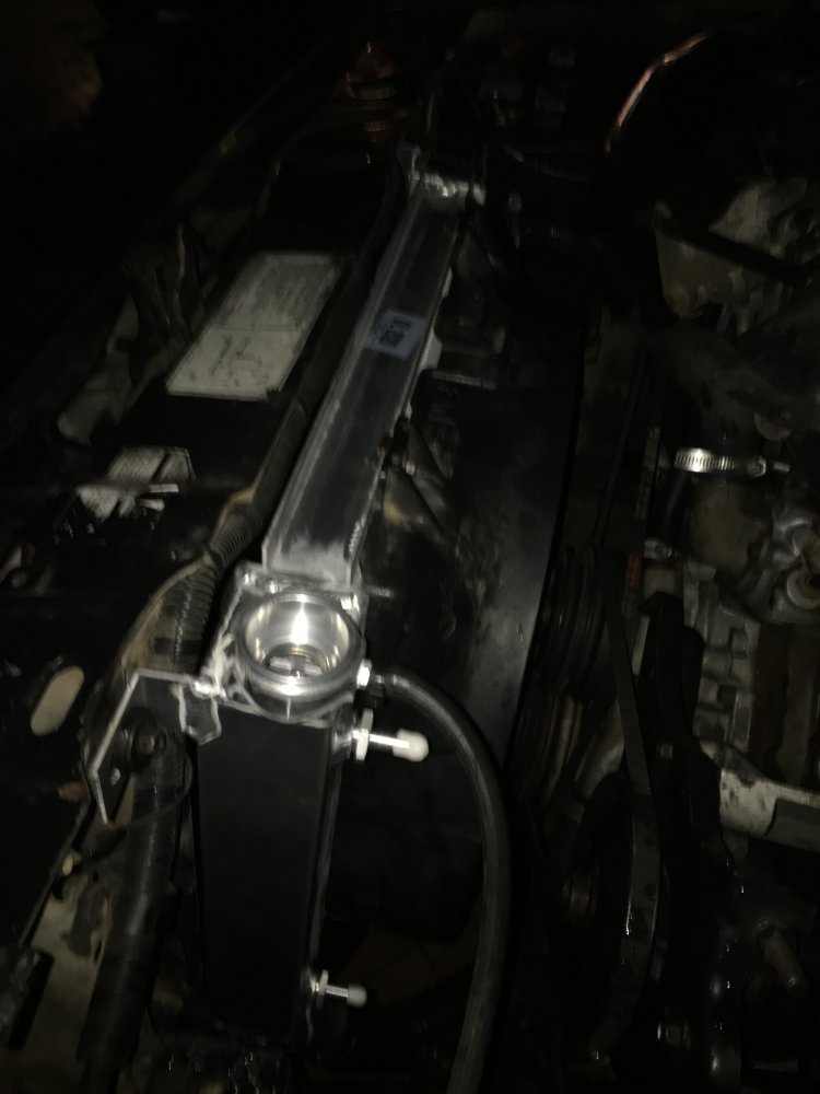

So, then I pulled the single core sieve away from the fan and installed the new double core aluminum. I was so close, but the bottom neck on the new one went out at a 45 degree angle from the original. I rigged it just to see if everything was working, but I don’t trust it. But, A RUNNING RANGER IS A BEAUTIFUL THING!! But the bottom hose connection was stretched and sketchy, so a trip to NAPA tomorrow.

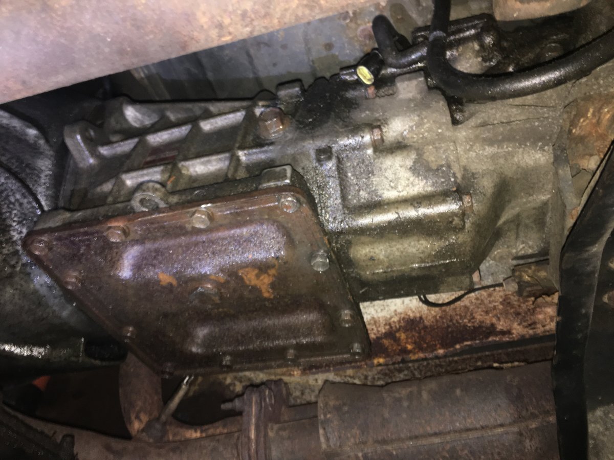

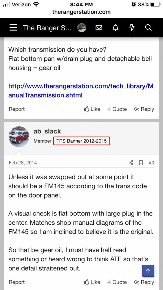

& finally a question for those wiser than me (pretty much anybody). Can you tell me which 5-speed manual this is? And what I really want to know is ATF or 80w90? It’s an 87 4WD 2.9 5-speed manual. Door sticker missing.
Oh, and the other final question: on my 97 4.0 2wd 5-speed manual, spec for the tranny is ATF. It has 312,000 miles, I’m pretty sure original tranny. A while back I had an 83 BMW 320i 4-speed and the tranny took 20w50. There doesn’t seem to be anything wrong with the Ranger transmission, and there are no unusual noises, but the whole thing just seems loud. Not a whine, nothing I think is broken. I was wondering what you guys thought of putting 20 W 50 into one of these ranger five speeds to see if it quiets down. It’s just slightly higher viscosity over the temp range and I don’t think it’ll affect the synchro shifting. Thoughts?
Ranger manual transmissions take either gear oil or Mercon V. I'm pretty sure yours takes gear oil. The post you quoted confirms my gut feeling.
