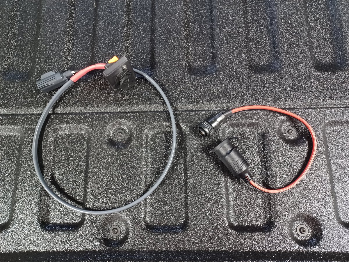

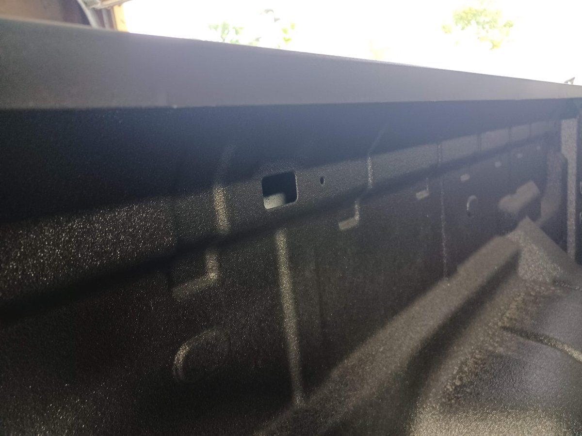

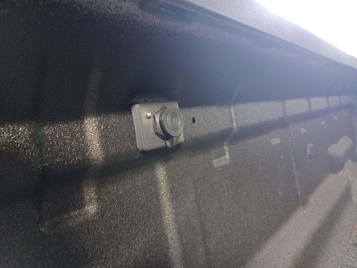

I installed a 12v plug into the bed of my '23:

It's a minor upgrade, but now I can plug my portable fridge into the truck first to cool it down before switching to the power bank.

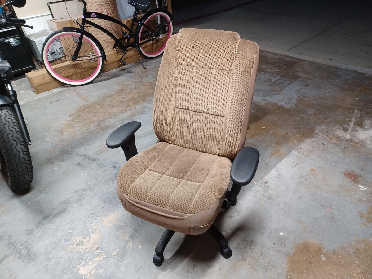

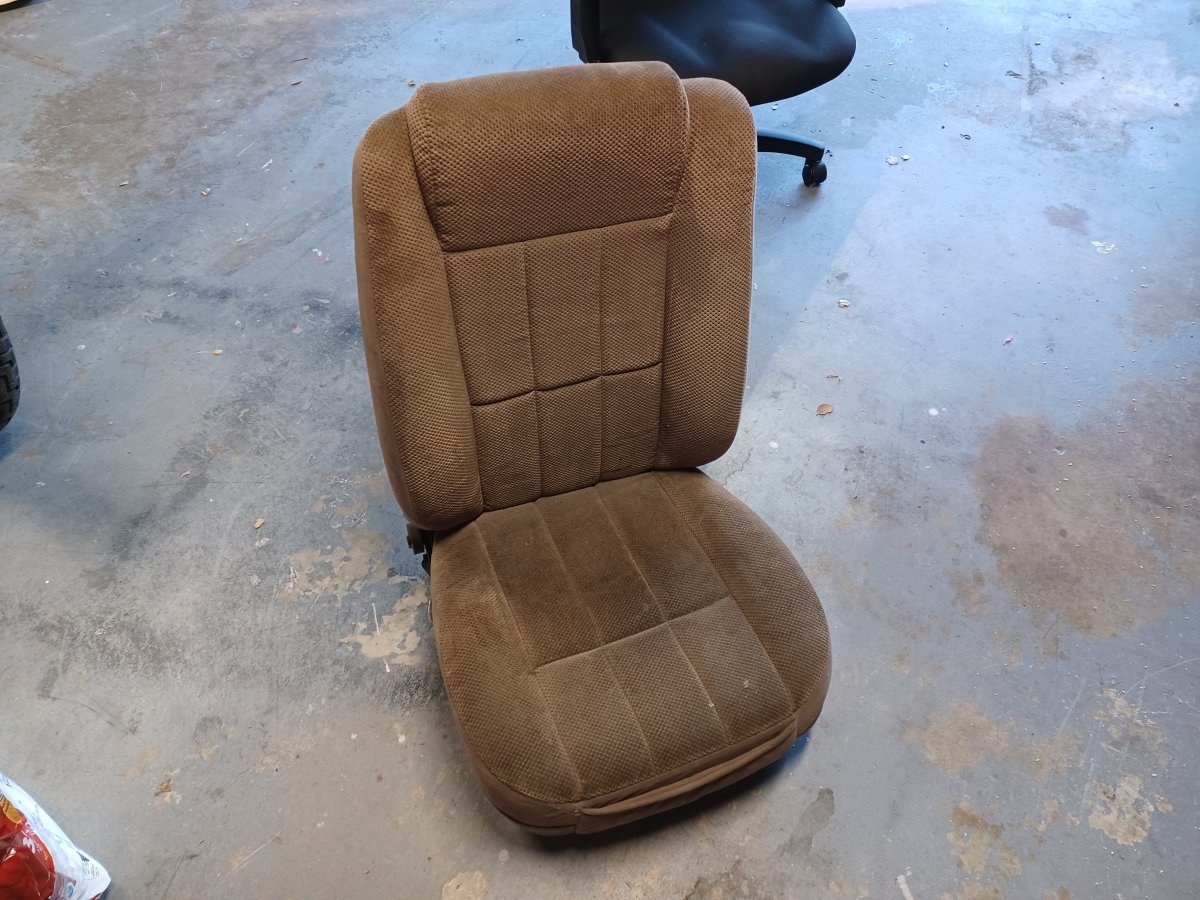

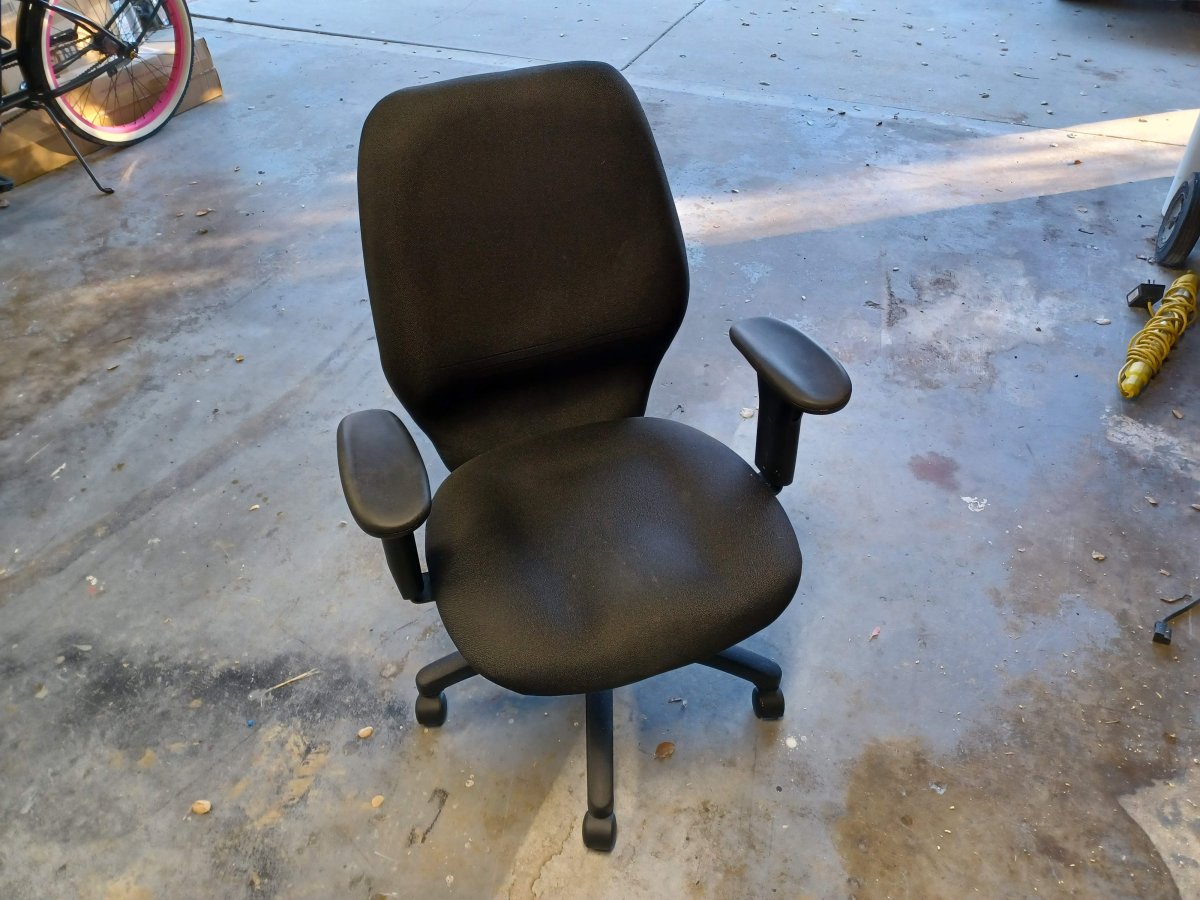

Not related to the '23, but last week I turned the old passenger seat out of my '88 Ranger into an office chair:

I did a bucket and center console swap forever ago, been wanting to do something with this seat for a long time. Proud of how it came out, had to share.

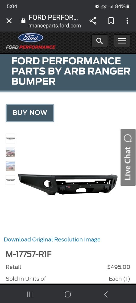

Anyone got one of these? The price is pretty dag gum good for a steel bumper. Just wondering if it comes with the winch mount. Anyone know? I can't find any info on Fords site about it.

How thick is the steel?
I know I have a tendency to over-engineer some things. But I would want it to be 3/16" thick material. Could probably get away with 1/8" (11gauge). But I have this problem where rocks and trees and dirt berms jump out and attack my truck kn the trail.

I can't find any info on that. It is ARB which is a reputable brand. It used to be $1000+ but I assume that the new body styles are coming they are just trying to move them cheap. It shows it with a winch on the site but can't figure out if it comes with the mount or is that extra. Can't find what size either. But I'm pretty sure my 10k would fit. That is if it comes with the mount.
That is a pretty good price. ARB does generally make good stuff but I would try to verify how thick the metal is. "Trust but verify". I would hate to see you buy a part that looks good but that is all it does is looks good.

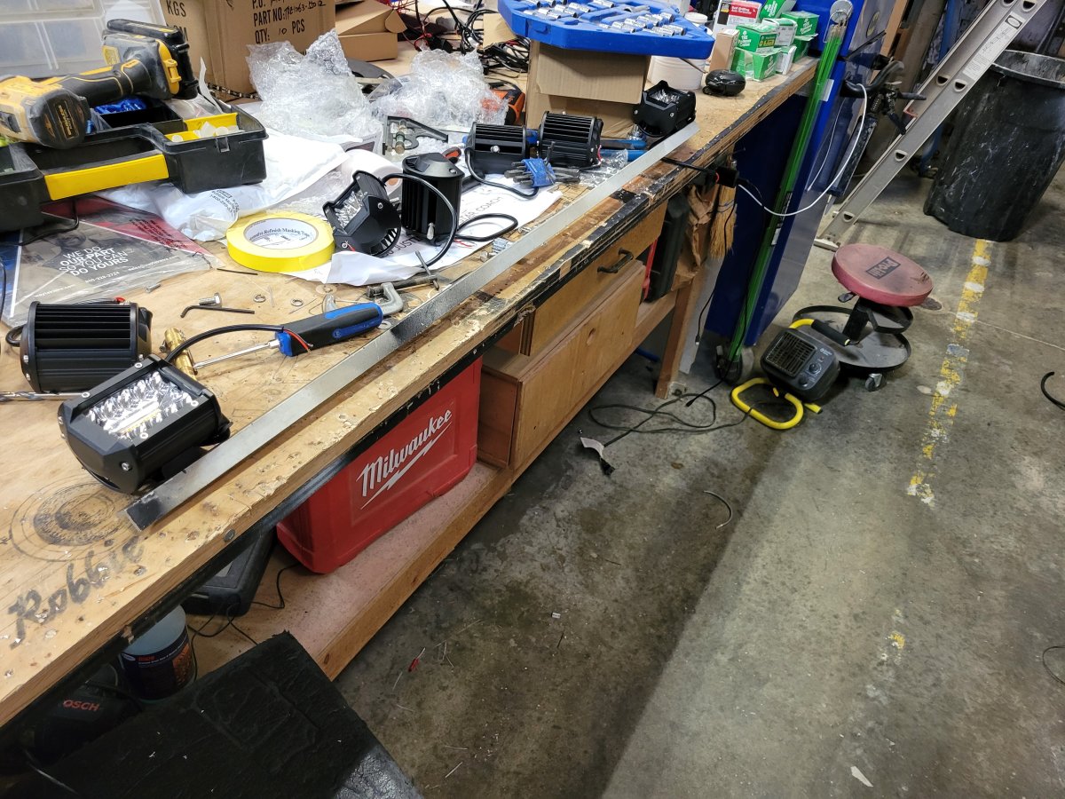

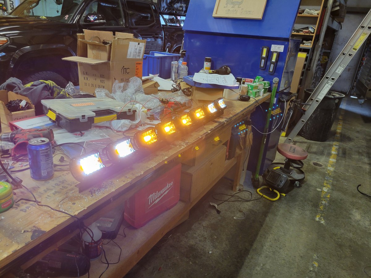

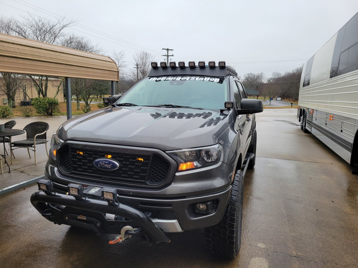

Built me a light bar today for the roof rack.

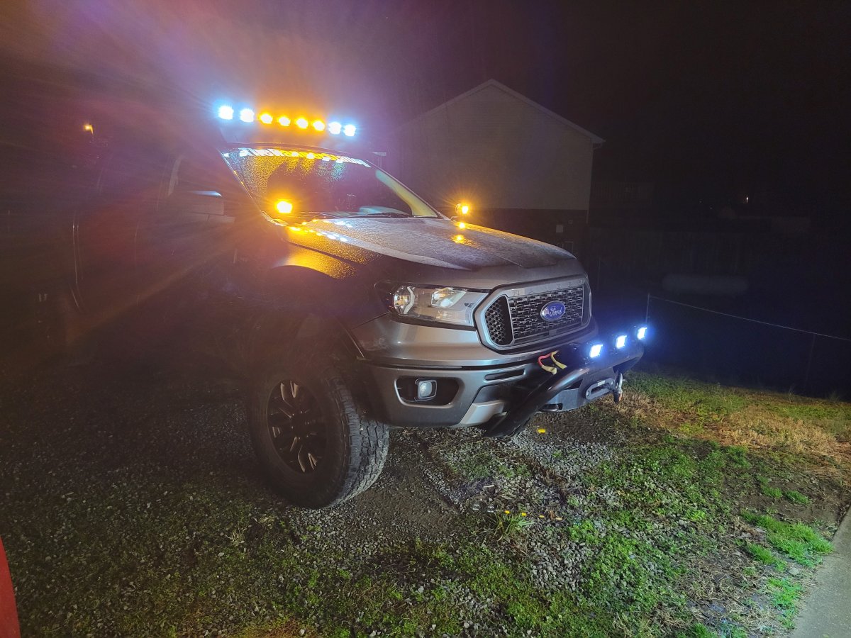

OK I went out and turned them all on tonight. I'm ready for the next night ride hahaha Can i lead?
What did you do to your 2019 and up Ranger today?

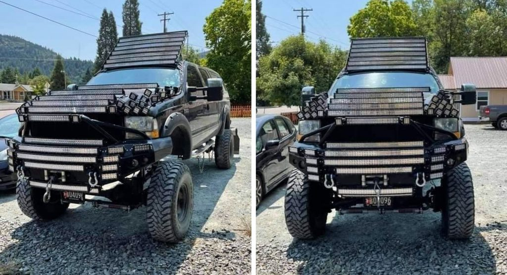

I feel bad for your alternator. It had to be screaming.
Believe it or not. It's drawing less than 20 amps. 5 amp fuse on 4 different circuits. Amp meter on the hot feed to switch controller show 16.5 amps with them all on. Got to love LED lights.
