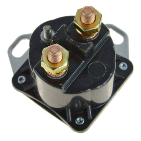

Before buying any parts, bolt the solenoid to the fender wall where it goes. Just to be sure it looks similar to this...
84-05 Ford; 85-03 Lincoln; 84-99 Mercury; 85-86 XR4Ti Remote Starter Solenoid Relay (Motorcraft)

Mine does have the "I" pin but it's the same yes. Alright I'll give it a shot! Would a not grounded solenoid cause a no crank situation?
Yes. 12 + volts from ignition switch to the S pin energizes a coil, creating a magnetic field which closes the contacts to connect the large posts together. If the other end of that coil isn't grounded, that won't happen; the circuit can't be completed.
