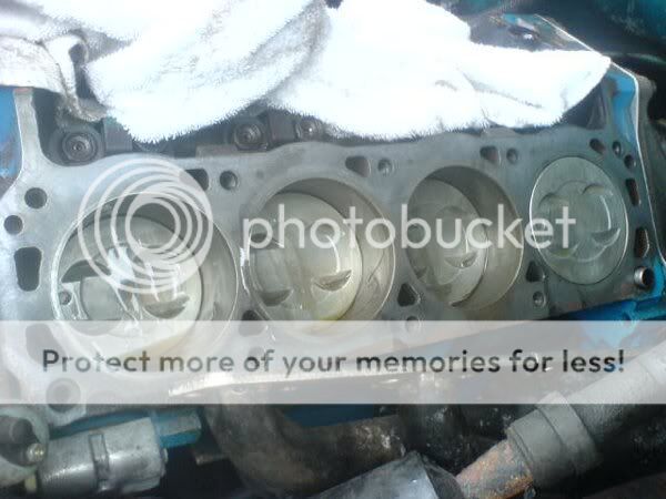

'92 Mustang short block, GT40 heads, 1.7rr, B303...
Ok. Are your pistons the same cut as mine? In 91 or 92 Ford changed from forged to hypereutectic pistons.
Stock, they would have been the same. (mine are still stock)
I believe the change was for 1993.
No PTV clearance problems with any that I built. I use forged flat top pistons in my builds.
