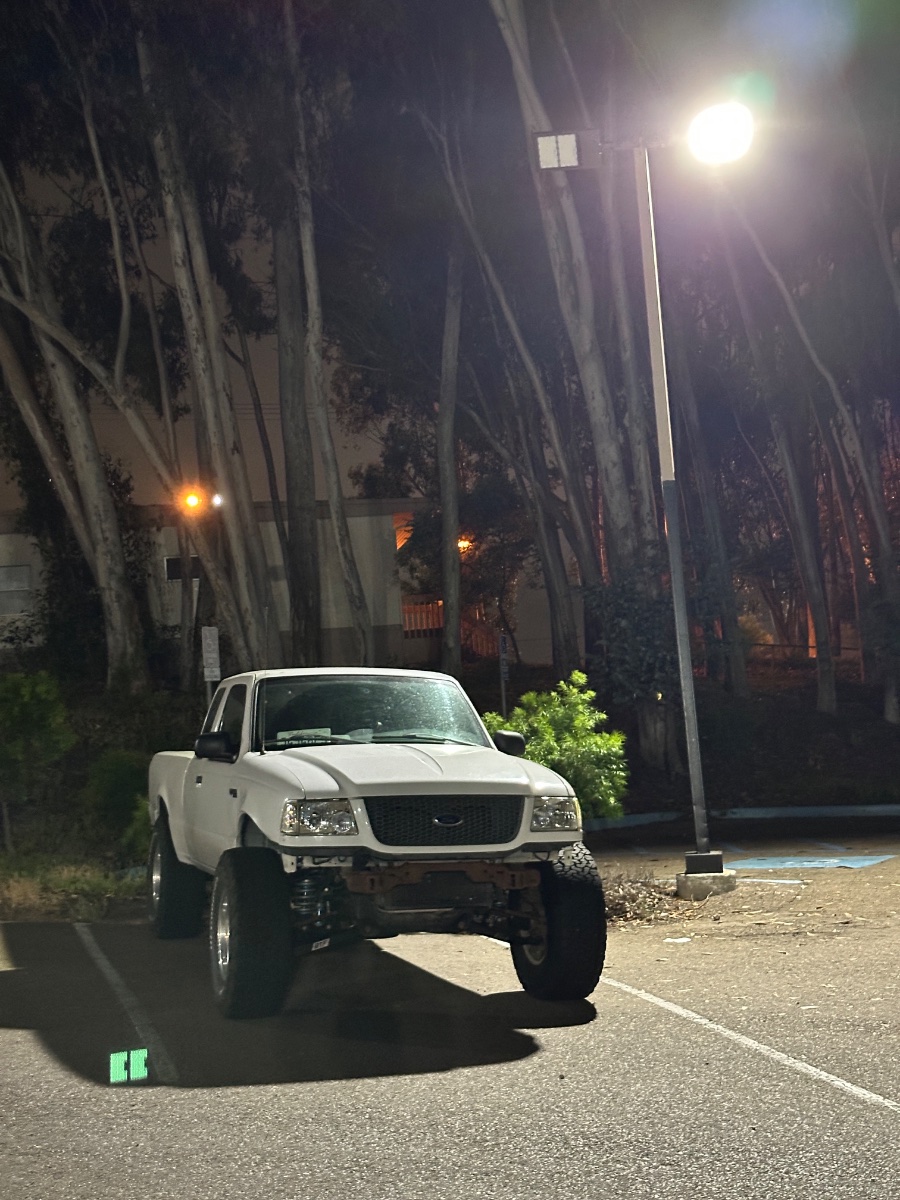

I am currently doing some maintenance on my 2003 4x4 Ford Ranger. And it’s time to replace the shocks. I do have a mid travel kit in the front and 35s all around so the truck is fairly off-roady and lifted although the back is stock I’m looking to replace the strut with something a little more performance/off-road. I know this isn’t gonna make a crazy difference or make the Truck crazy capable, but does anyone have any recommendations on some solid shocks considering I will thrash the car 😂

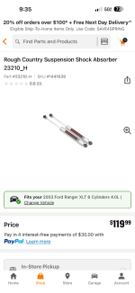

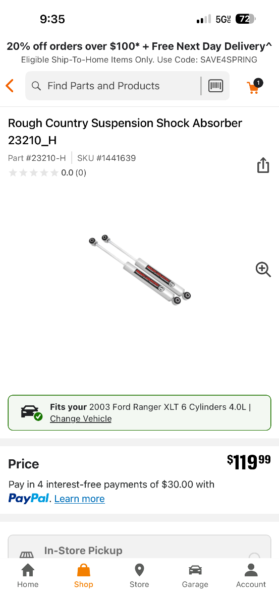

I took the recommendation and got the RC 23210-H
