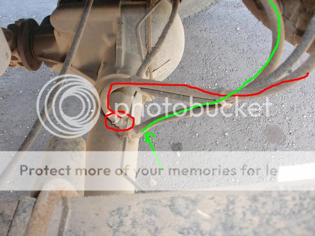

OK Thank you.... now what do I do if there not there? On the rear axle there is only one tube that comes out of the Diff, witch splits and goes into the brakes..(Is this normal ?) In the front I did notice a rubber plug looking thing in the right spot that; it could have been a tube at one point in time.
Like this?? (I just found this, was fueling up a work truck, new F150 and I snooped and this is what I saw) The green is the breather line, notice there is no visible fastening device, the hose just pushes onto a barb. The red is your brake line, dont fuss with this unless it is damaged (then pinch it off with vice-grips and limp home) or you are doing a lift, then it needs replaced with a longer one. Notice the crimped fitting on the end of the brake line.
Triumphrider did an excellent job of showing you where the lines are, if you cant find them after those pics then there is no helping you, lol. Just teasin.
PS: there is a difference between 'waterproofing' and winterizing.
I know I'm trying to get both done, Water Proofing so I dont have to worry and Winterizing; I really am not sure what all is involved.
I crawled all around the truck last night and the rear axle HAD NO BREATHER!! There was a rubber plug in it, I pulled the plug out and there was a grommet in the axle housing fairly obvious that it was not meant to be plugged. I also noticed along the frame there was a hose in a "barb" that was about 3 feet long and completely disconnected (on both sides) and tucked away, so I shoved the hose into the grommet and suprise, suprise perfect fit. Now I just need to buy a fitting to lengthen the hose and get it out of the way. The pictures really helped me figure it out. Thank you very much. Now figuring out a way to fish out the one for the front...:no2:...
