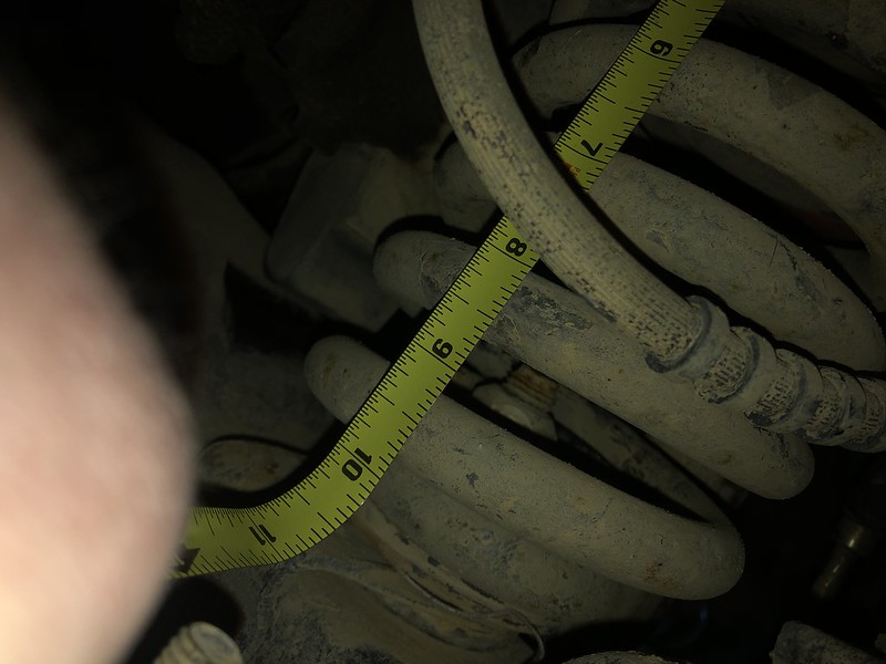

That looks like it might be closer to 10.5" to me... (you need to measure from each end of the spring).

Doh.
I have it drove into the garage getting ready to swap the rear springs so I was doing all this while almost doing a headstand. I didn’t thing about that bottom coil, I probably couldn’t even see it from where I was.
I will have to try again...

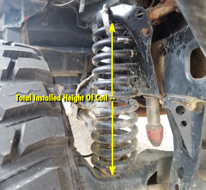

I'm still looking for the installed coil spring measurements of James Duff, Rough Country, and Superlift lift kits.
After installing Skyjacker 1.5-2" lift springs the measurement is now 12" versus the 10 3/4" with the original springs. 1992 Ex Cab, 5.0, 4x4,full size truck 5 speed, NP205 TC, 3" body lift.

Stock springs: 10 3/4" 1992 Extended Cab, 5.0, stock bumpers, no suspension lift, 3" BL, full size truck M5ODR2 trans., NP205 TC and I'm putting Skyjacker 132s on it this weekend.

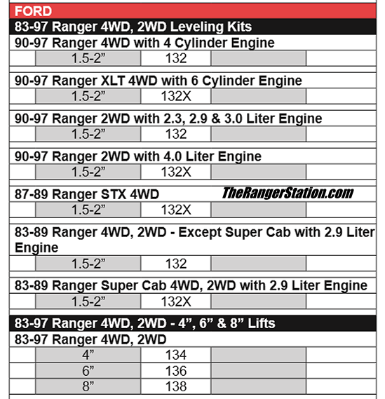

are you putting 132's?" or 132x's? and i cant find a difference between the two... but please let me know what you decide to do on that, im looking to put about 2-3 inches lift on my ranger, and would appreciate the info.
Here's the difference between the Skyjacker 132 and 132X springs.

I called skyjacker this morning the representative told me that the 132 is 14 5/16" long with a ppi of 445 and the 132x is 15.5" with a ppi of 397
