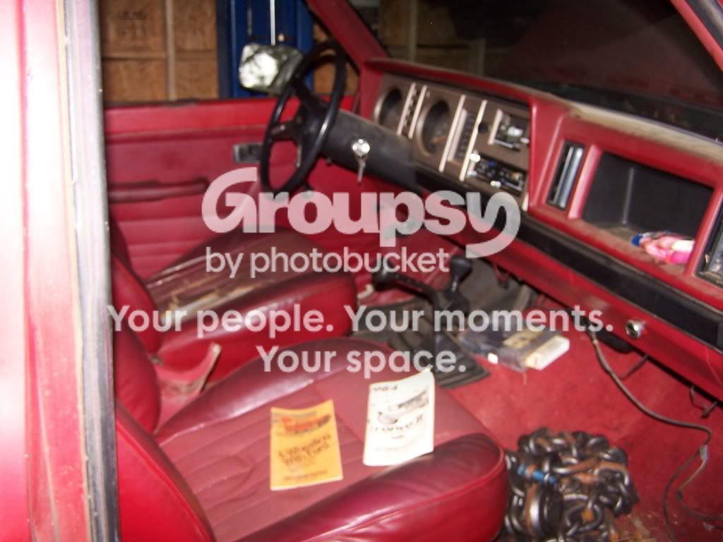

Interior shot for fun.

Dorking out with owner's manual and a "4x4 for dummies" booklet from Ford
