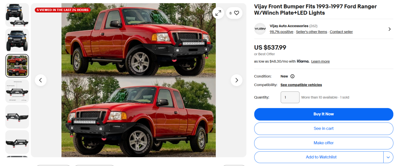

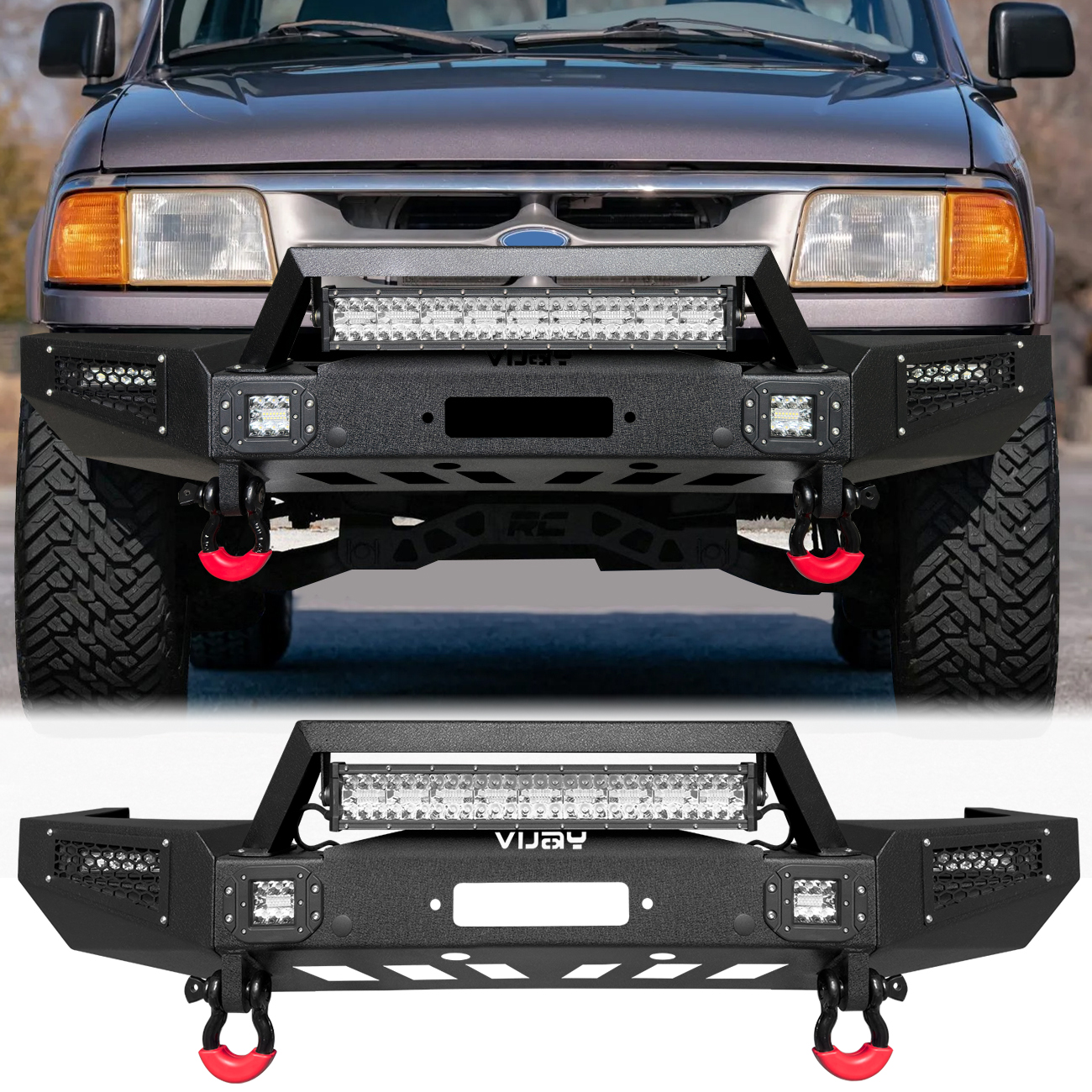

Anyone have any experience with the Vijay Front Winch Bumper for a 1997 Ranger? Looks nice but I have never heard of it and am looking for some feedback on it...how strong is it mainly as I will typically use my winches regularly in the backcountry.

I have looked at those and other similar but the reason I liked the Vijay is that is does not stick out as far. Looks like it could potentially increase approach angle while also keeping a more "factory" look. I have built custom winch bumpers myself before and would likely go that route but for the price of the Vijay I am not sure it would be any cheaper...guaranteed I would over build it though and it would definitely be strong enough!!!
Din't know anything about them. If it's made of 3/16" or thicker steel, you could get it and reinforce it as needed in weak areas.
Can't speak to that one, but most of the (admittedly cheaper) bumpers I've looked say 11GA if they say anything about thickness. Leaves me to think the others are even thinner...
Interesting that the description says 93-97 but the truck in the ad is much newer.
"The bumper body is made of heavy-duty, high-strength 7/64-inch steel, and the winch plate and mounting brackets are made of 3/16-inch steel."
Correct pictures there and on the Amazon listing as "Veromca" brand. LOL
7/64” is less than 11ga.
In my humble opinion, cardboard would be stronger.
7/16 = 0.109375
11 GA = 0.119
1/8 = 0.125
It might not sound like much, but it's a significant difference in strength.
I wouldn't be surprised if you could bend the outer portions of that with bare hands.
For reference LMC sheet steel for body work on the Ranger is 20 GA = 0.0375

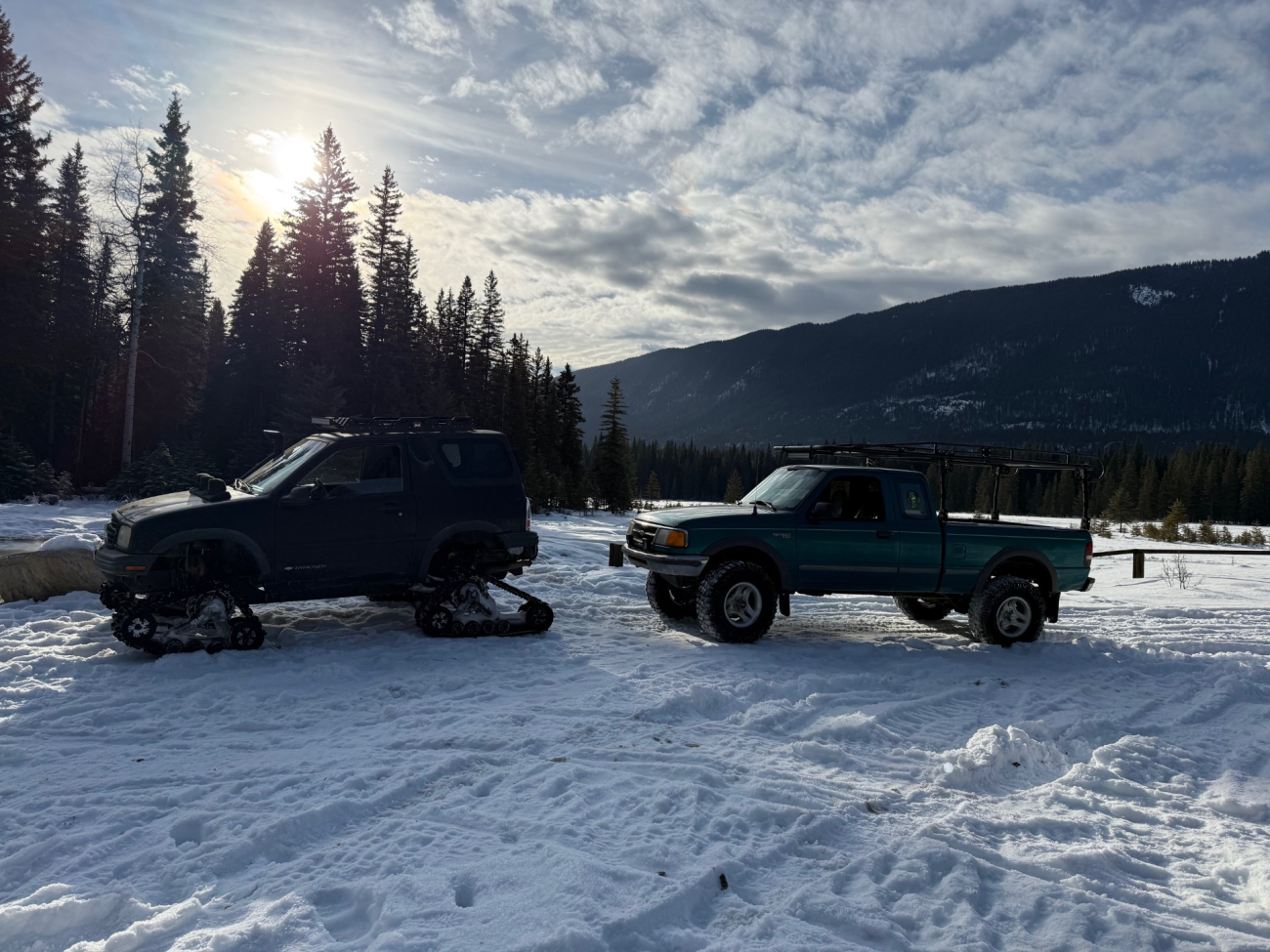

Needed to add a pic of the Ranger now...can't keep the old toys in the spot light. Pic is from yesterday out with a buddy.
