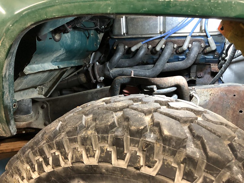

I used the $100 tri-y headers from ebay. With a 351, you gotta trim the frame rail on the passengers side a little, maybe 3/4 of an inch wide by however long to clear both tubes. Supposedly with a 302, they fit witout trimming. Pics are here

They fit mine so well, in my opinion, because they totally avoided the frame. I've seen too many V8 swapped Rangers and Bronco II's that the passenger frame rail was butchered beyond belief. All I did to the frame was smooth the factory edge a tiny bit, but it didn't need it.
Mine also fit so well because I've been a fabricator for most of my life..
