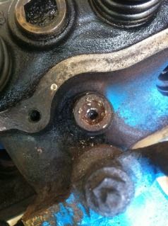

Try beating an allen head socket in the bolt head. It's a long shot but I've gotten it to work before.
Well that has been tried but a no go. Imma weld a bolt head to it and get it out that way.
Welded a bolt to the top to the bolt and pulled that sombitch out!
Atta boy! Way to us the noggin!
