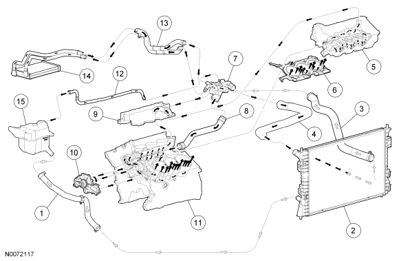

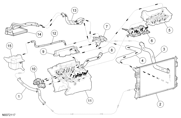

Did not find this cooling flow diagram on the TRS site, believe it's a Ford diagram.
Found it searching the net for "ford 4.0L coolant flow diagram". On a Ford Flex website, as close as I could find. Did not see anything on the TRS 4.0L tech pages. Don't need any more fake news...right.
:icon_confused:
The Flex (and I am a fan of it, but never touched one) never got a 4.0L. It was also transverse mounted drivetrain for the engines it did get. That would match with the diagram you posted, but not with the Ranger's (or most longitudinal mounted drivetrain) cooling system.
It was a good thought, just bad resource.
