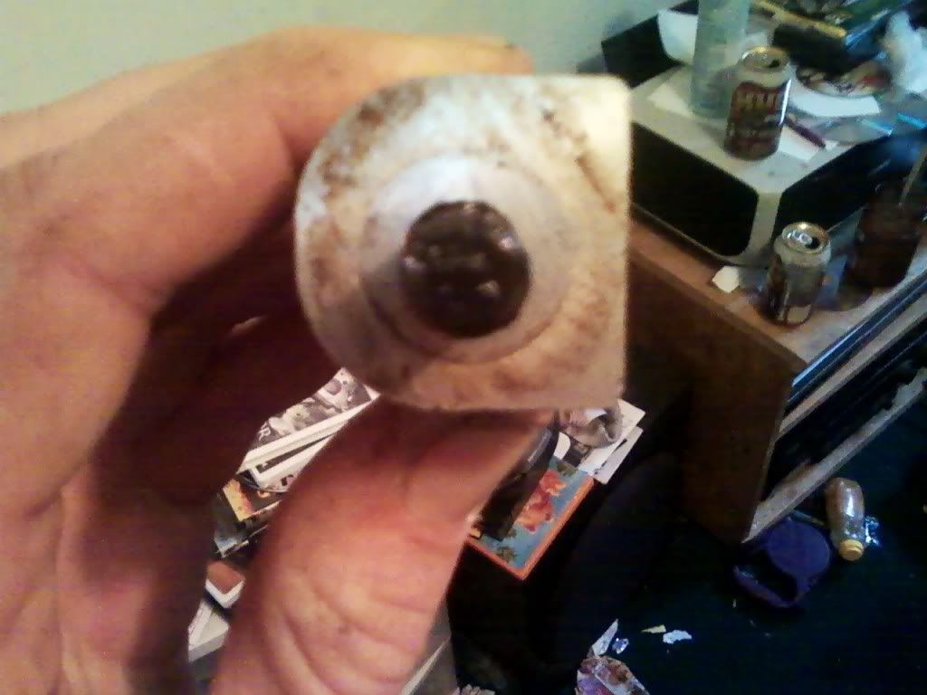

One thing Ive found and it isnt mentioned anywhere is The rocker shafts all get all their of their oil from the center Shaft pedestal:
Updating the 2.9L Tech Page - Suggestions Needed
Which then has to pass through here:
Now to me this maybe the main reason for starving the top end of oil and I for one will be modifying the oil passages slightly The shafts may get plugged regardless but it may help if they got better supply
