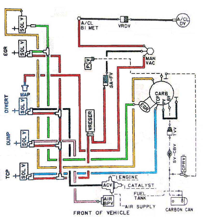

Not sure how much it matters as the non-duraspark 2.8s seem to be a dying breed, but the 1983 vacuum diagram on the tech page is for a 1985 2.8.
Attached to my post is the diagram for a 1983.
