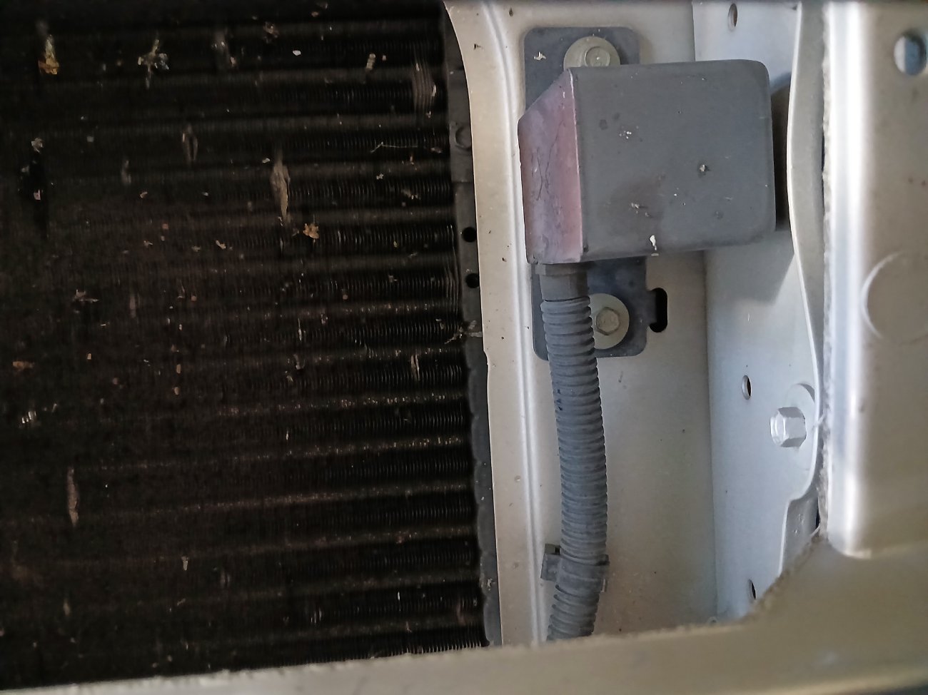

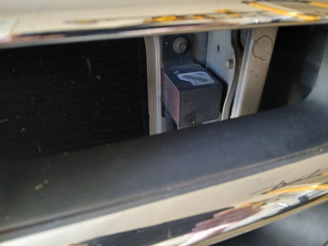

Can someone tell what these are. One is behind the grille on driver side. I believe it to be air bag impact sensor, not Sure.

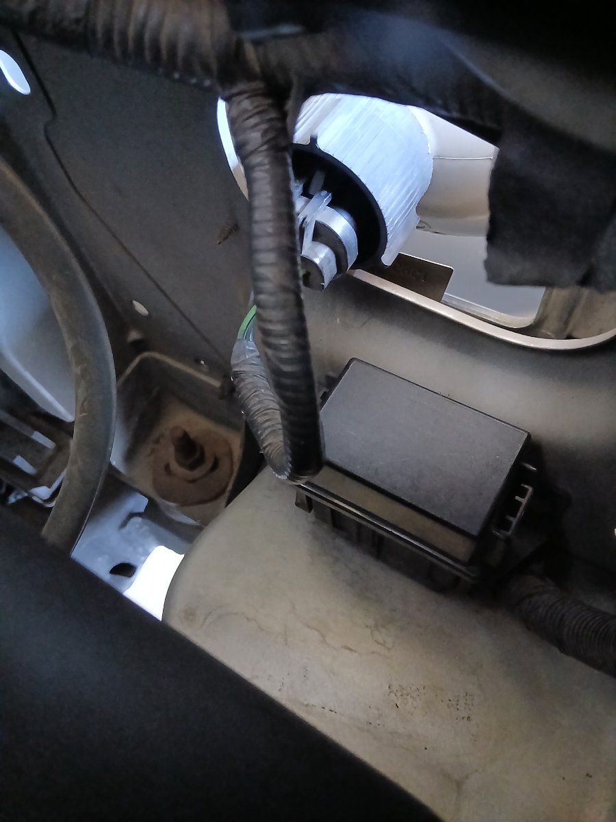

Other is below air filter housing on passenger side.

Airbag sensors. Or at least that’s what they look like.

The photo under the passenger headlight looks like the rely box. The relay for the blower motor is in there.

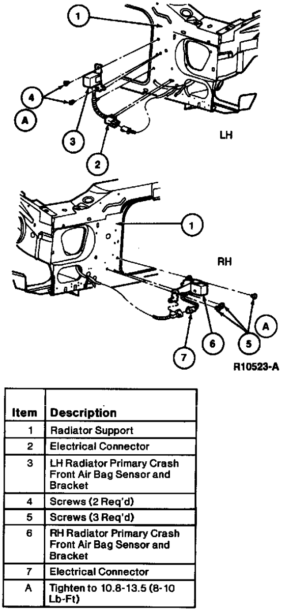

First picture appears to be the crash sensor. The other one houses the blower relay and wiper relay.
