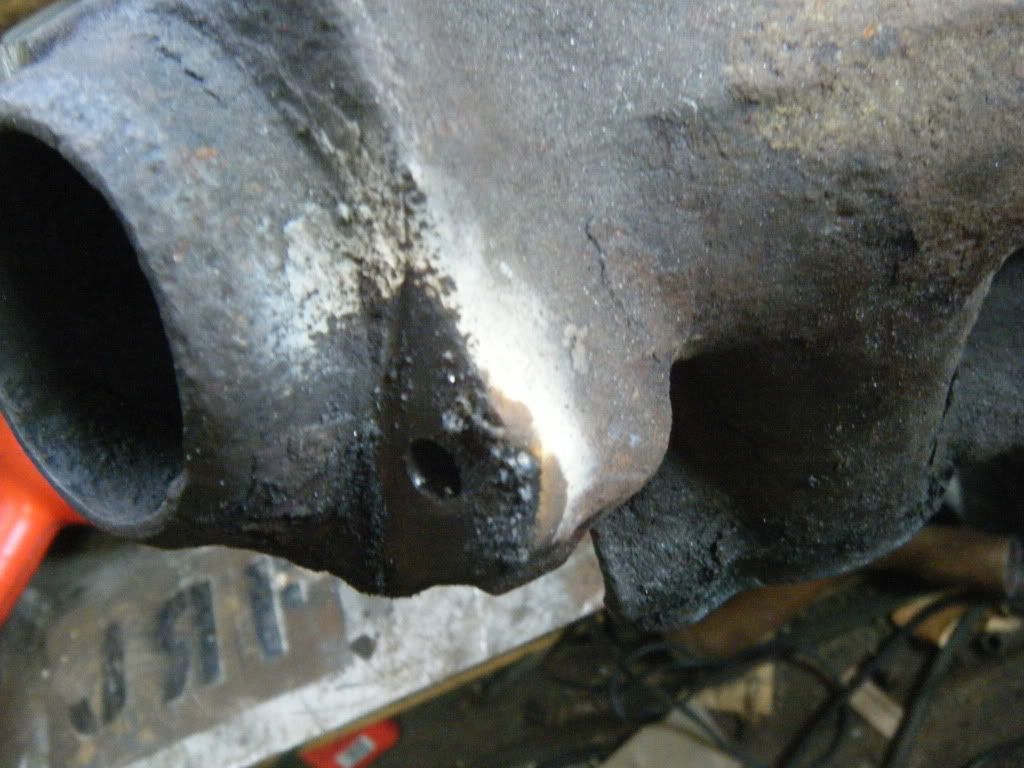

well i started drilling with a small bit and drilled right through perfect after i sharpened the bit on the bench grinder and then i went to put in the bigger drill bit and the drill burned up on me. so the only other one i had was battery powered and not worth a damn so i said f it and grinded it off down to bare metal and heated it up and tried welding on a bolt. it worked good but i was only using the small mig so i got it tacked on anyways and tomorrow im gonna burn it on with the big arc welder

this manifold is done, ill use bolts through these..

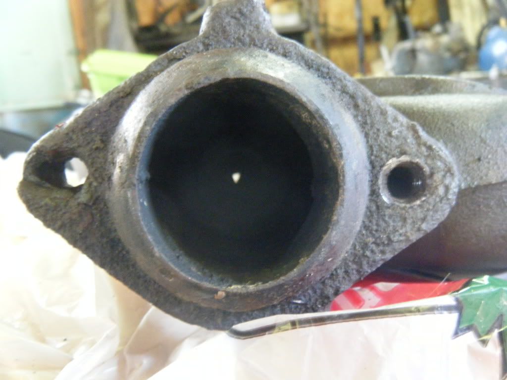

will also use a bolt through this one..

but this one will require re drill and tap (got it drilled, just need to tap it now)
