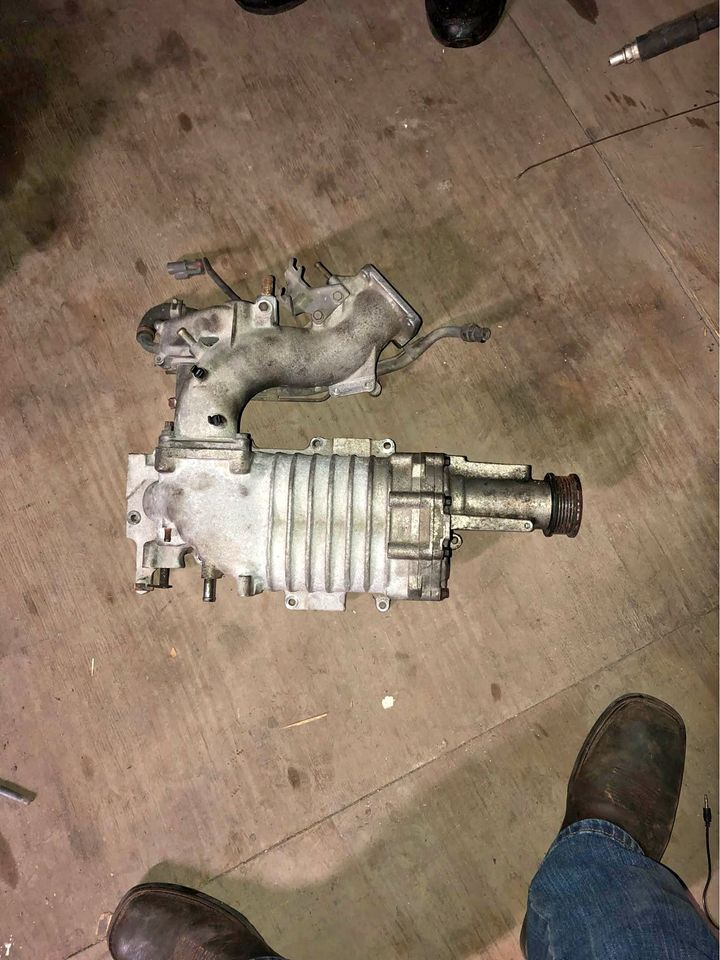

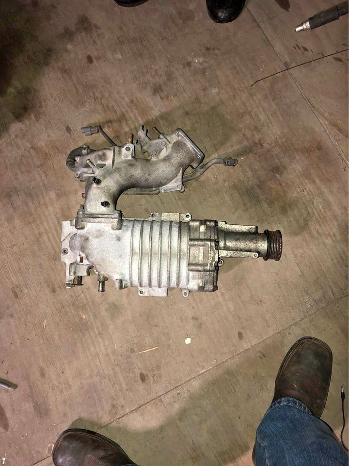

i wonder if a supercharger from a late 90s / early 2000s nissan frontier or xterra would be a good option for someone wanting to boost a 3.0? those nissans had a 3.3 v6 in them.
i say that because there is one on marketplace in san antonio for something like 100 bucks, if someone is looking for one to play with
What kind is it? That would probably be a good size. Fabbing the intake is the hard part, in my opinion. I've got a project to build a supercharged 3.0l. But it's been on the back burner. Wish I could find the Whipple setup and have things a little easier.
let me find the ad. i will put it here for you.
he has it for 220. i had the price wrong. i would offer 100 though as there are few and far between supercharged nissans left so no one is going to buy it from him. its already been listed for two weeks. and he is in the middle of nowhere. he will get very little, if any hits because of his location
googel says this about it
The Xterra actually came with a factory supercharger on some models. That supercharger is an Eaton M62 (with modified side intake port). The Bonneville also has an M62. The M62 is commonly regarded as too small for the VG33 (V6) in the Xterr
If I go with Eaton, I was looking more towards the M90
I was going to mention that the Supercharged Nissans (SC Frontiers got 4 doors and a long bed, Xterra's are all the same layout SWB/4door ) are NOT much more powerful than their N/A siblings. I dont remember the exact numbers, i just remember being underwhelmed. Not sure if it's the SuperCharger's fault or the VG33's fault.
Its the 3.3. Its not a power house, at all. My 3.0 ranger feels like monster compared to my frontier
