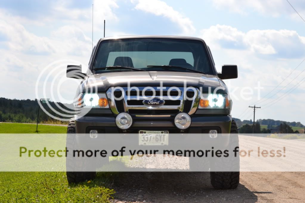

Does anyone have pics of a truck with fiberglass that has the stock width stance? I am curious to see how ridiculous it will look in between installing the fenders and getting the long travel kit that widens it. They suggested 6 inch fenders, but any pics are good.
Thanks in advance if you can find any, I have looked for a long time and found nothing.
This is with 4" fenders, a stock width diff and 10" rims/13.50 wide tires, not a great pic but it works.
Tucking 33's
So based on that pic, which looks like your tires are close to flush if not a bit wider, if I went with 6 inch ones, stock rims and something like 11.5 inch wide tires, the fenders would stick out like, what, 2-3 inches? That might not look bad, might look odd tho. :dunno:
If I went with 3' wider fenders and 11.5" wide tires, it wouldn't look bad I imagine. But if I switch to the long travel kit later I will likely need to buy new glass again.
All that based on the assumption that my 07 would behave relatively the same as your straight axle width-wise....
hmmmmm..... ugh decisions :annoyed:
Suggestions anyone? based on this info
heres 8" rim with a 4" offset, (3.75 stock) and i have spindles that widen 1" per side. i have stock fenders. 6" fenders on stock rims will look strange IMHO. also, long travel kits cant use stock rims as they wont clear the upper uniball. dixon bros mentioned that to me when i was shopping for my friends 2008 4x4.
heres 8" rim with a 4" offset, (3.75 stock) and i have spindles that widen 1" per side. tires are 32X11.50R15. i have stock fenders. i'll be running 3" come spring time, winter will just beat them up. I'll be ordering from McNeil.
