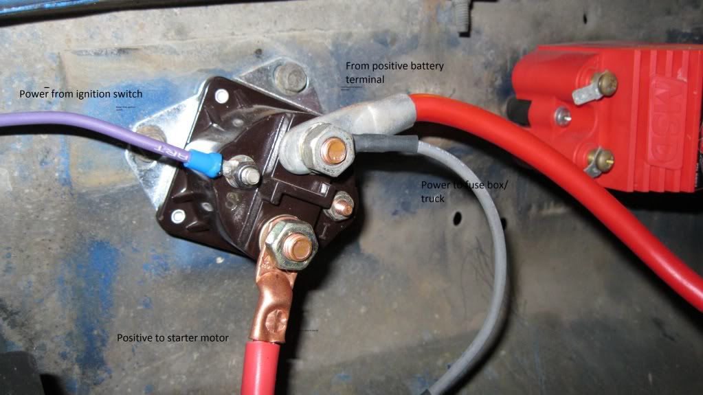

Can someone get a pic of they're solenoid and how its wired up please

Thanks H311RzR,
Mine was/is wired up the same way but i have 2 extra wires connected to the stud that the wire from the starter motor is on
that stud is only hot when the ignition is in start. I dont know of anything else besided the starter motor that only needs power when in start, i could very easily be wrong though.

I ran a wire to that side so it would adjust my Duraspark iginiton during cranking, it is possible it is something to do with something like that :dunno:
Mine also has a wire from the neutral safety switch running to the post marked "I" in the picture. It is a neat little elbow connector that slides on. As I know from my experiance, without that thing plugged in I am dead in water.
