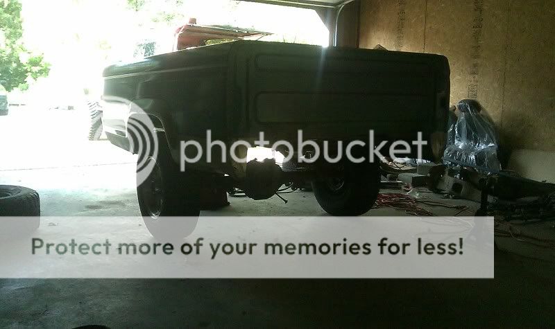

It won't be going down any trails with me. And the person I got it from has a matching fiberglass top for it. I told him if he still had it when this is finished, I'd get it from him.
And the B2 doesn't even have reverse lights
I was thinking of doing this to my rusting bed off my 84, either that, or just cutting off the outside fenders and using the sheetmetal to make some quick wheel well fenders. Just gonna use a hammer, light torch, and something round.
Well the B2 doesn't even have reverse lights
umm why not? mine does.... :thefinger:

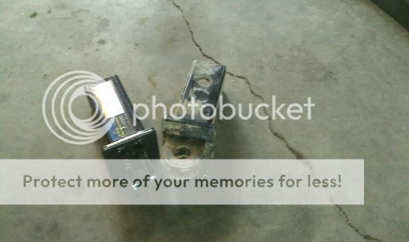

Have these. Could make a double pivot joint.

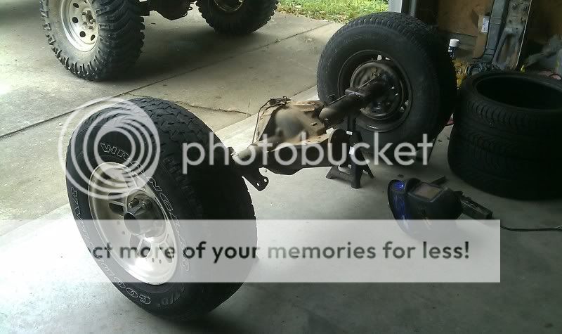

Trying to use what I got. Thankfully I have my stock rear bumper and this spare 8.8. Rims came off the donor Explorer.

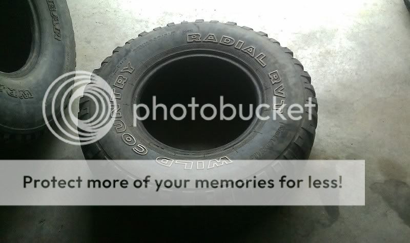

Will be using those tires for the now, but will have these 32s put on later.

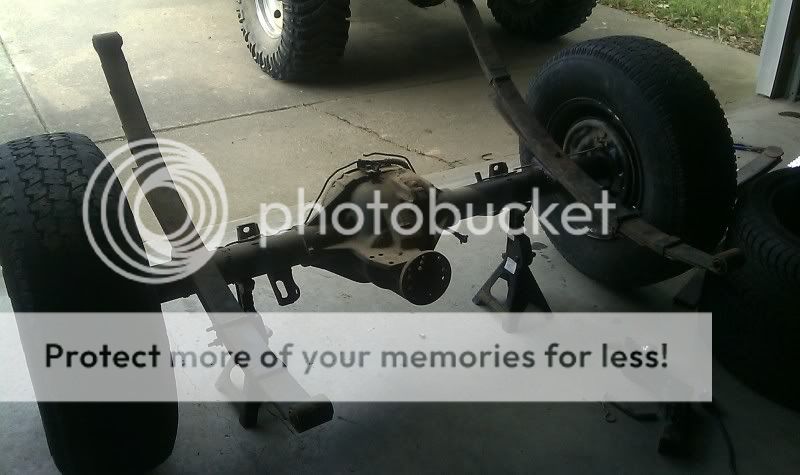

Only thing I really need are tail lights, tailgate, and some leaf springs, but I am supposed to be getting a set of FSB leafs tomorrow for $20.
Pffffttt....pay $250 for a coupler I can make? I think not...I like its design, but I will make my own!
:icon_thumby:
exactly, way to pricey for something pretty simple.

i would run some gussets in the corners or run some X's on the frame
