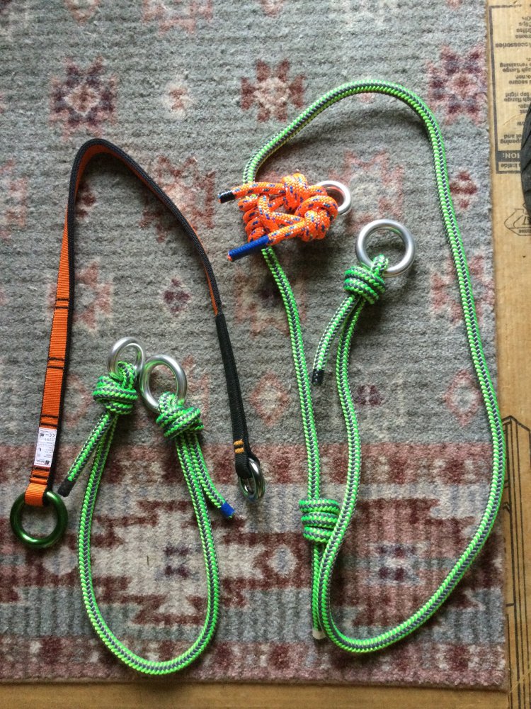

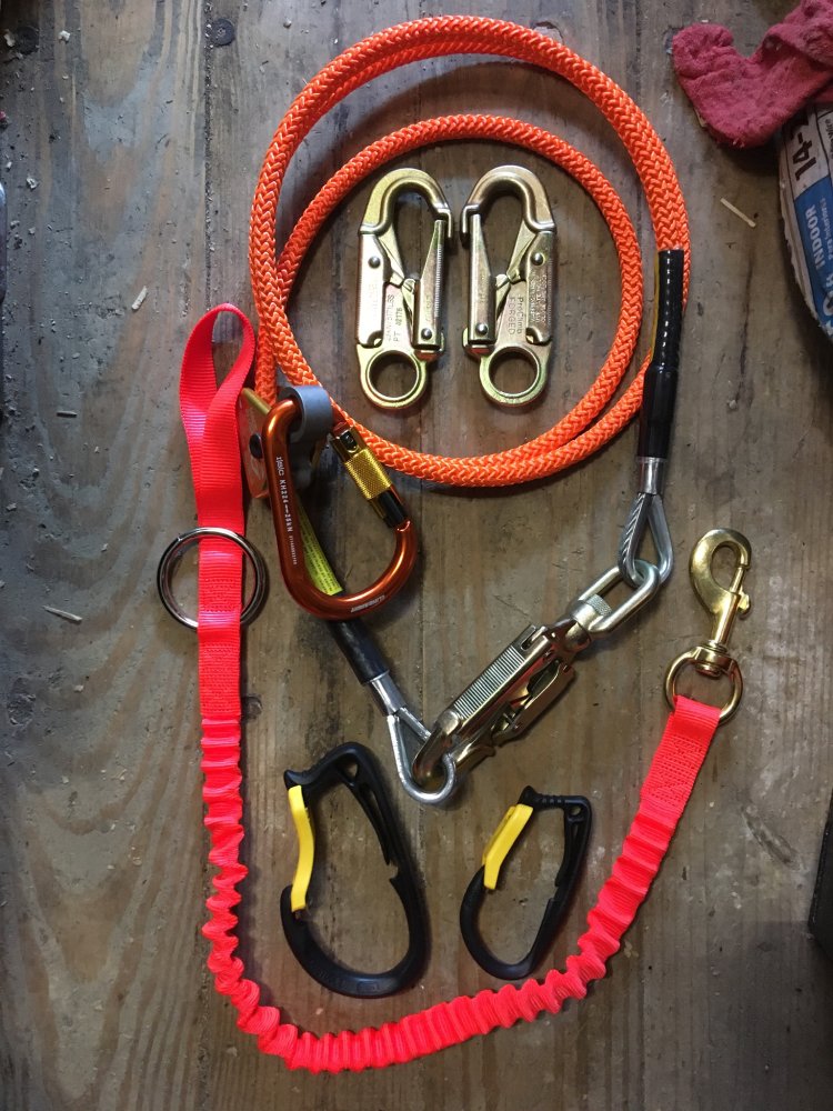

For climbing I have my complete harness (Petzl Sequoia SRT) with the chest harness that makes it into a fall-arrest rated harness. It’s put together and largely adjusted. Have a spare rope bridge but didn’t think about it, I need a ring or swivel for the bridge yet. Also considering getting a different length bridge just because. Got a couple Petzl OK carabiners too. I had a couple locking carabiners from off brands but figured I’d use the Petzl ones for climbing and the others for other stuff. Still need a lanyard, I’m thinking steel core might be a good choice just for safety. I could use some of the 3 strand and make a flip line/lanyard but I’m leaning towards just buying a steel core.
A retractable saw lanyard is on the list.

So the last of the climbing stuff should be here today minus a spool of rope, still haven’t settled on one yet. I did pick up a bag of rope “scraps” that may or may not have a length of climbing rope. But it will have pieces I can use for odds and ends. Got the friction saver, a ring for the harness and the lanyards. Cable one for me and retractable for the saw. I’ll get pictures at some point. Some of the stuff got here Tuesday and I put it away before thinking about a pic.

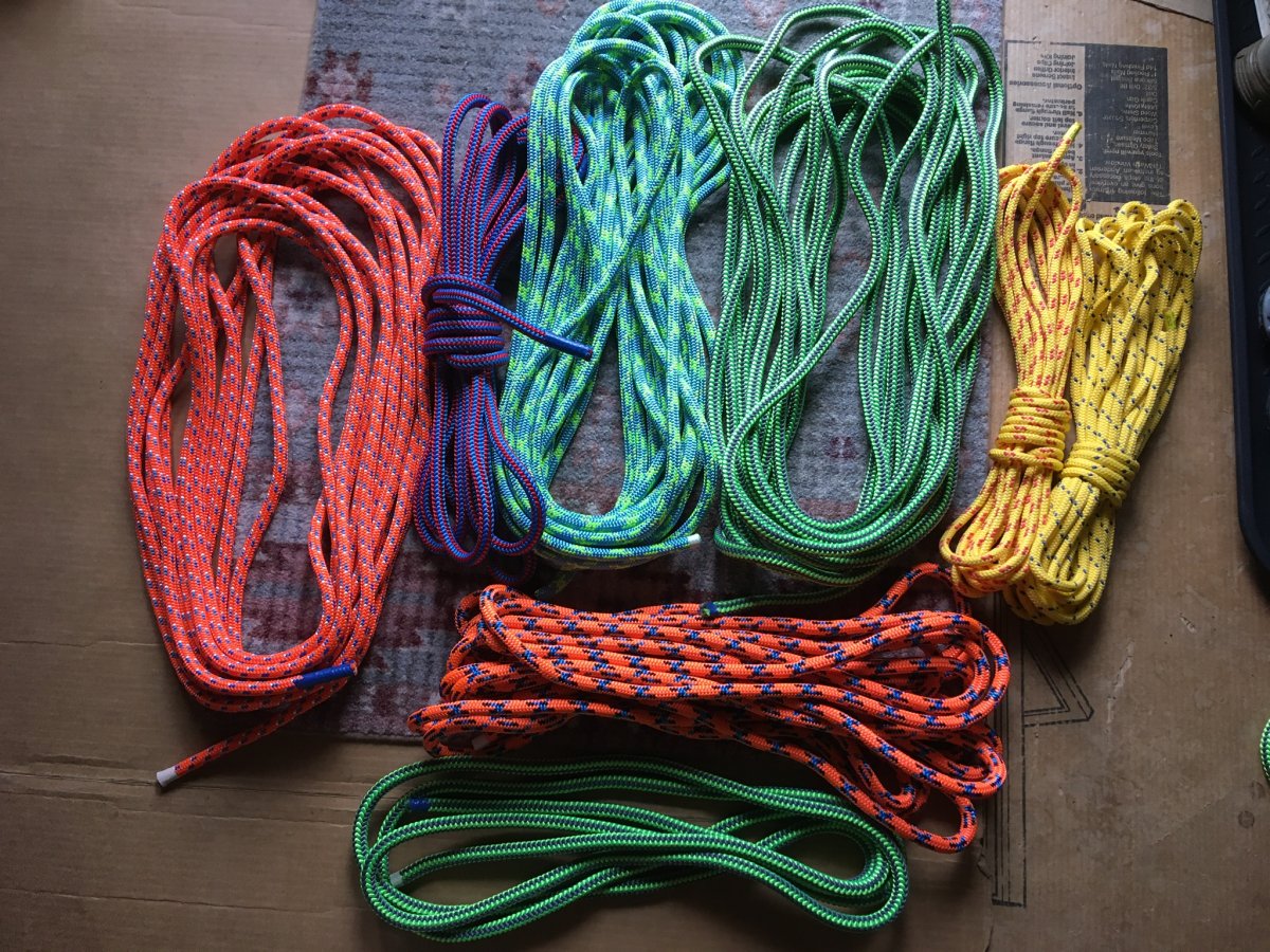

So I ended up with three lengths of rope in the 40-60’ range out of the grab bag. Two of them are rated for my Akimbo and one is unidentified. Then there’s a 50’ length of another that the core pulled out. Not sure if that’s useable for anything. Couple short lengths, well, two might be kinda long but it’s more for boat use which is fine, it will go on my boat. I was able to salvage a length that still had the core off the one long line and that made me two more friction savers, a short one and a long adjustable.

So I still need to pick a rope and order it. The only other things I need I can manufacture here (bag cannon and porta-wrap). Tried searching and even the people claiming to review ropes just present what they’ve used and like and don’t really recommend much of anything. Most of the ropes on the list of what’s approved for use with my gear have mixed reviews. Most are positive but there’s a few that say it’s junk for one reason or another. Usually some issue with not working right with their gear but they don’t specify what gear or climbing techniques. So that’s inconclusive too.
Yesterday I messaged the one company and asked specifically for rope recommendations based on my gear and intended climbing techniques and was given a few recommendations, but most of them I had to disregard because it’s off the lighter weight table for the Akimbo (I should have been more specific) and between me and my gear I’m going to end up somewhat close to the cutoff (220#) and I’d rather have the extra safety margin of the second table (286#). The recommendations they gave for that was one rope they don’t sell and two Sterling ropes (Workpro and Scion).
Now. In the rope grab bag I got there was some 16 strand rope ( nothing approved for my gear) and a length of Notch Banshee and Sterling Scion (both 24 strand). I like the coarseness of the 16 strand ropes but it makes me question how well it will run in my gear. It would likely hold up well to whatever I would do with it though. I have a 16 strand option available, the Sasquatch. There are a couple 32 strand ropes available but I don’t want to go that fine. The Notch Banshee seems like a pretty nice rope but the reviews were either it’s the greatest ever or it’s completely worthless. Of course, once again, nobody specifies what gear or how they use it in the reviews so there’s no telling which side of the fence I’d be on. The Sterling Scion is some really nice rope, at least for the little bit I played with it. But it’s also the most expensive. Not many reviews for that though.
My original intent was to pick a rope and buy a full spool, saving roughly $50-100 over buying that much by the foot. Then cut the spool into a couple lengths, say a 100’, two 150’ and a 200’. That way I don’t have to drag out a 200’ rope to get 50’ up and I can use one rope as a main access line and other ropes for moving in the canopy. That said, I can use the couple 50’ ropes I got in the grab bag for shorter stuff. So do I still buy a full spool, and if I do what kind do I go with? Or should I be worried about having all my ropes the same that I might mix them up in the tree and I should have different ropes for the different lengths so I can go by rope color for which is longer? I’m heat shrinking the ends and using a paint marker on the heat shrink to label length so on the ground at least I can tell how long it is. Should I just get a 150’ or 200’ rope for now and deal with having miles of extra rope for most climbs? Couple of the oaks and hickory trees around here are pretty tall. This whole thing is giving me anxiety and I want to get whatever I get ordered by Wednesday at the latest. Just not entirely sure what to do.

I think you will really like the camming on the steel core flip line. Mine was like that. When coming out of the tree, especially on DRT, never do it over a single branch, using a figure 8 or Petzl Stop. We had a local guy fall out of a tree that way, when the branch broke, and now he is in a wheel chair for the rest of his life. Have fun! I am now trying to lose more weight so I can get back into the tree business.
