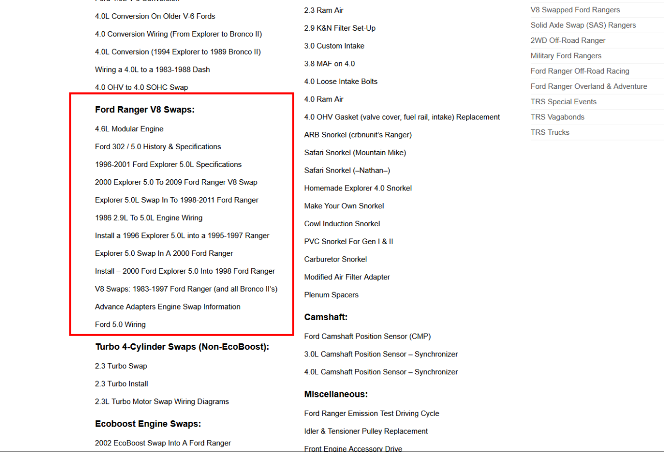

Just in case you haven't found or read through it all yet, the engines sections of the tech ref has tons of info.
specifically the V8 swaps...

the article for swaps into 1st/2nd/3rd gen is going to be your wealth of info:
scroll down to "Transmissions:"
