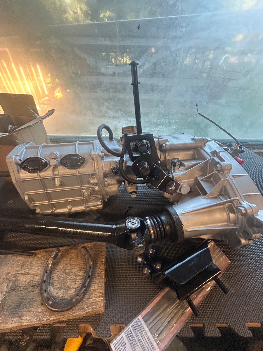

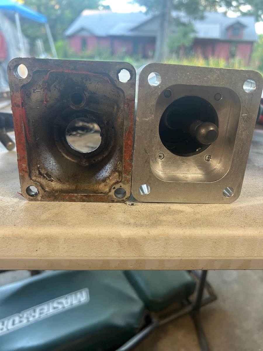

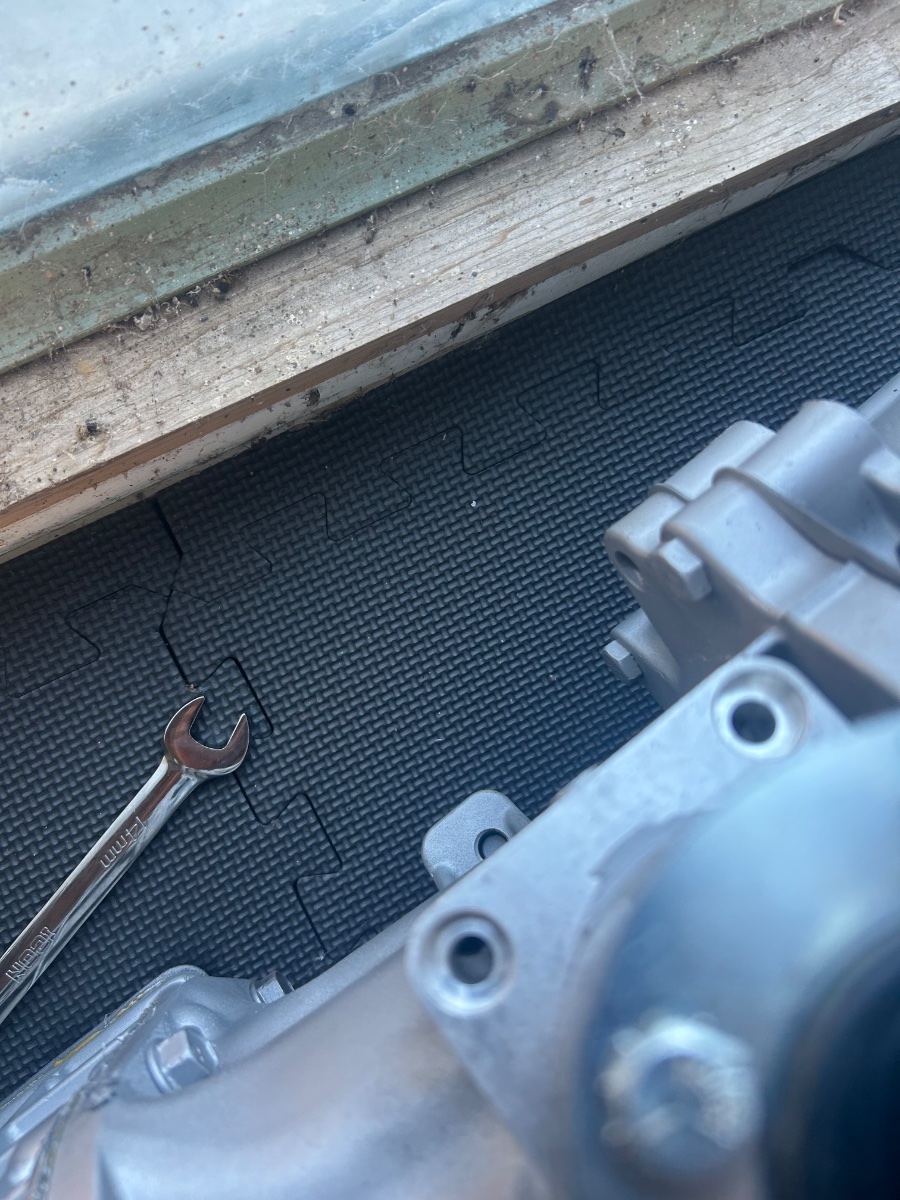

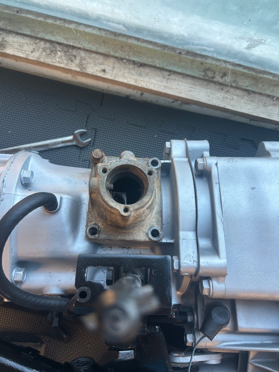

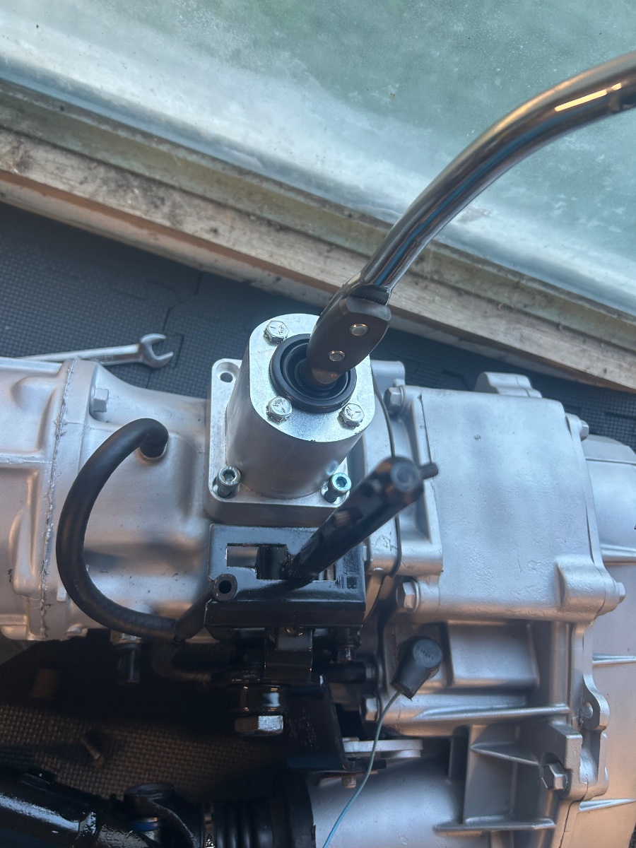

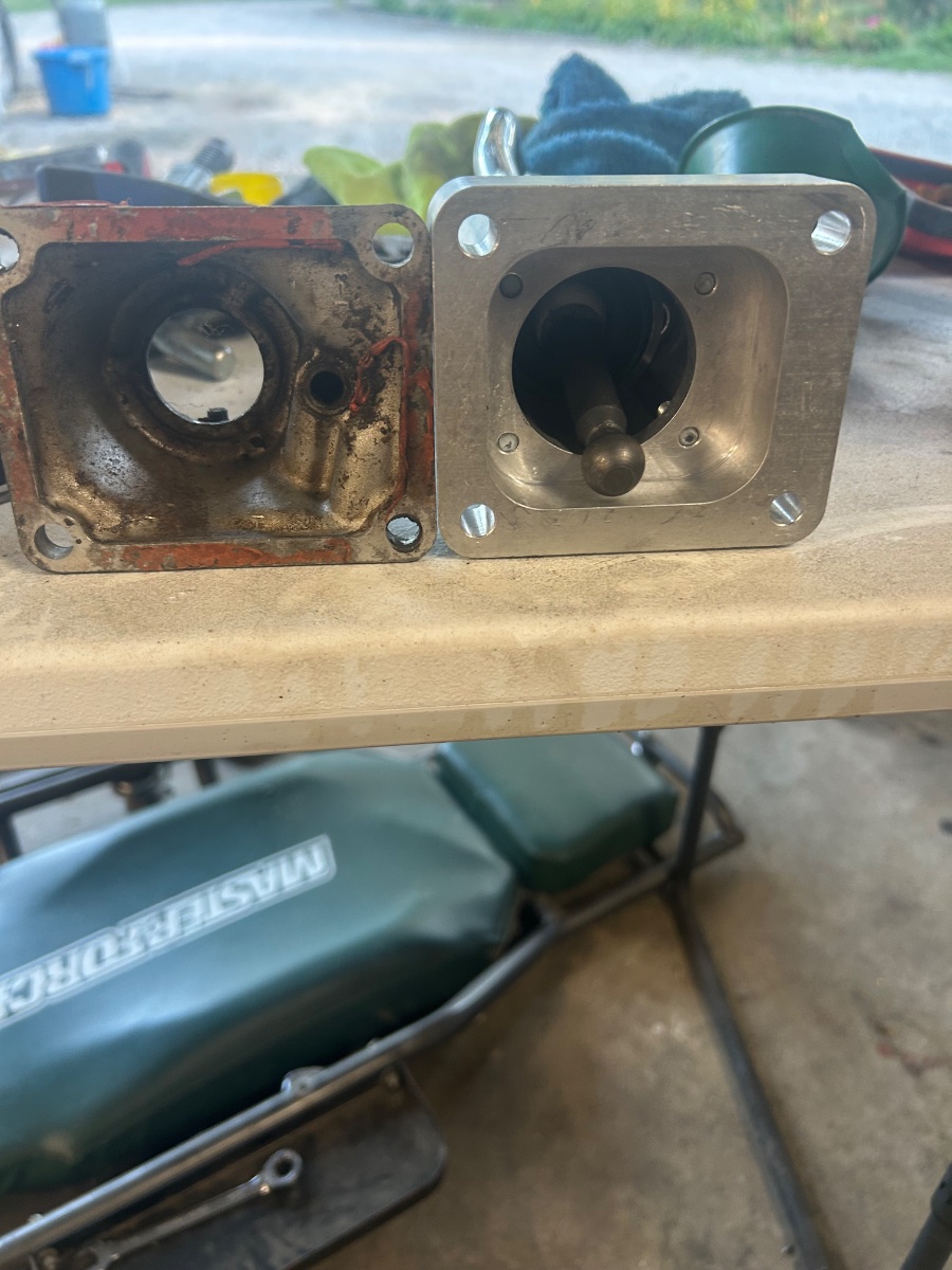

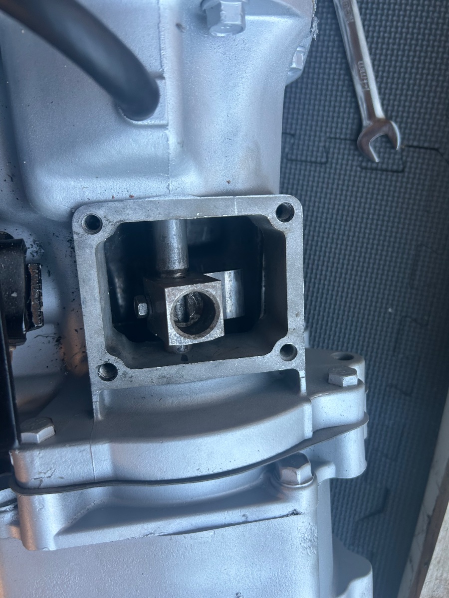

I’ve got this transmission I bought a tk4/tk5 shift kit from core shifters but it doesn’t fit I thought it could the fm145 or 146 but the bolt holes aren’t at a small slant so if any of you know please comment. Thank you.fyi there is no identification tag on it and I don’t have the original truck from it

It's not an FM-145 or 146. Those don't have those black plates on the top. This page seems to confirm that what you have is some TK variant, scroll down to the bottom:
I would suggest reaching out to Core Shifters and see what they recommend.
Just figured it out it’s a TK5D it’s for the 2.2 diesel Perkins
