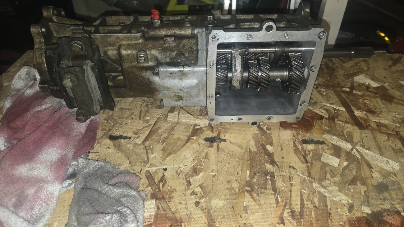

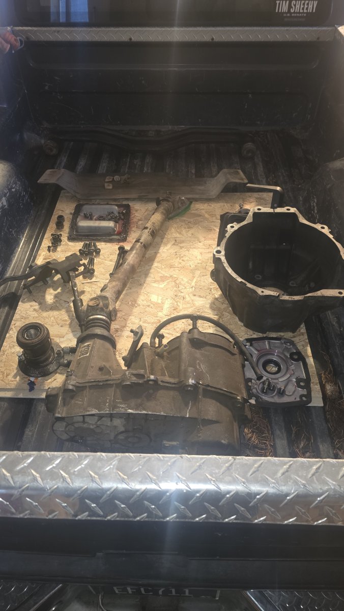

Parts have been ordered, now I just have to wait impatiently. Really hoping to have it on the road next weekend.
I'm going to run the mtf if I make it that far. Haha

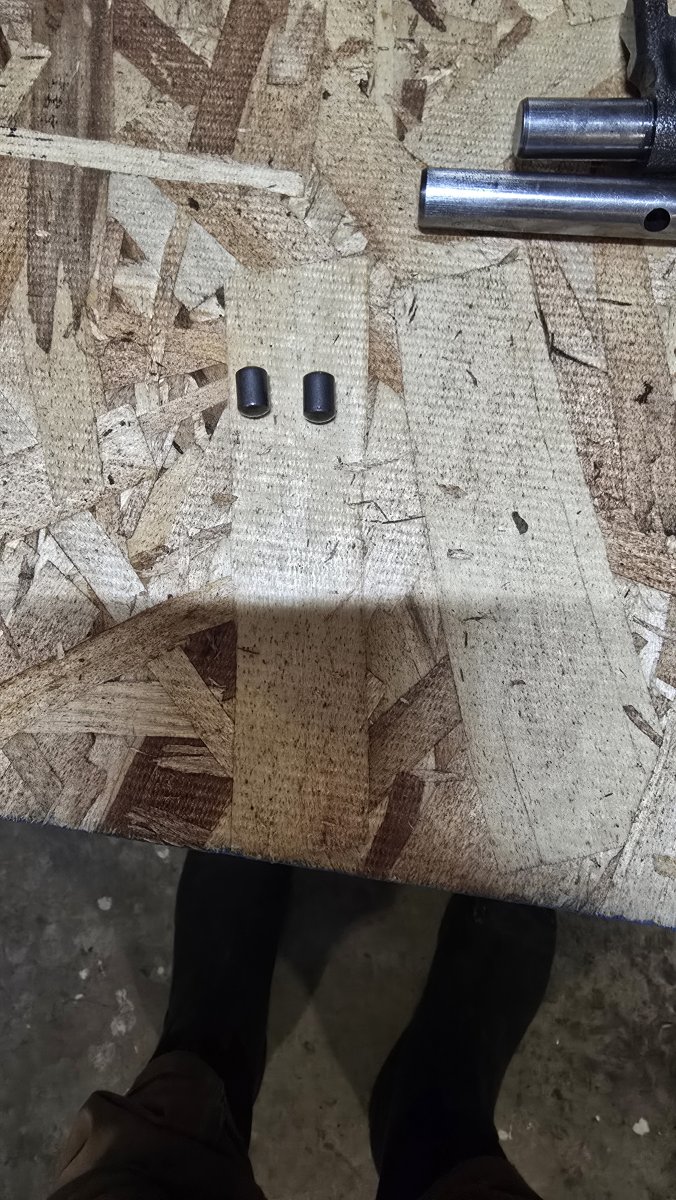

So I'm chugging away on disassembly and these two little nubbins popped out while I was loosening the countershaft nut. I can't figure out what they are with the parts diagram. Any idea what they are?
Thanks guys.
Pretty sure those are shift interlock pins, IIRC there are two threaded plugs on the side of the trans and springs below those plugs, and the pins go under the springs. They prevent the transmission from being in more than one gear at a time.
Indeed. They were not labeled in the parts diagram, but were shown in a step in the assembly instructions. Thanks so much for your help! I got it all back together and it runs like a champ.
