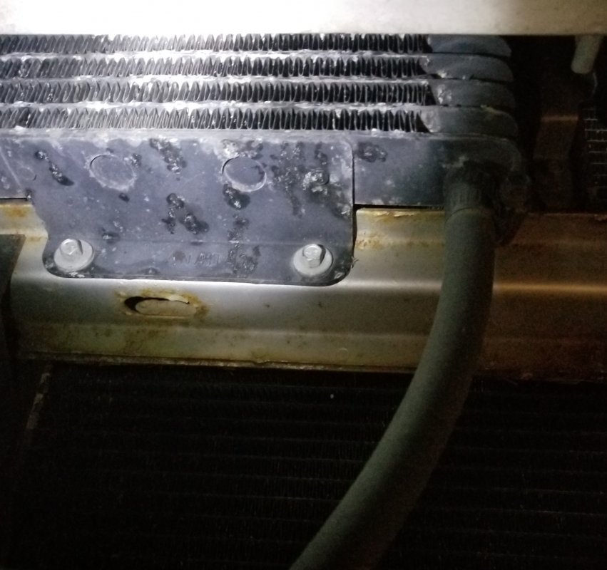

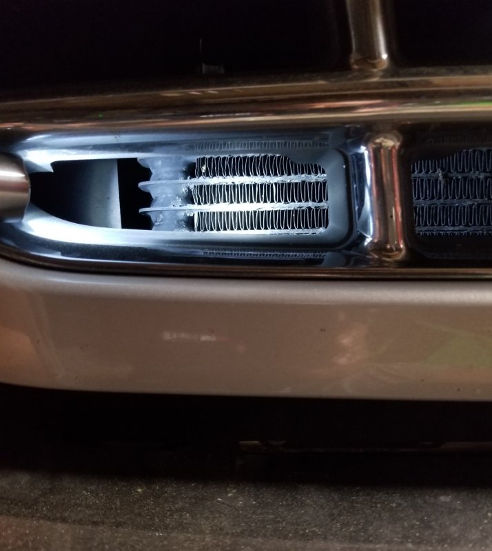

RonD, I just checked my truck and there's a 2nd cooler behind the grill! Looks like I am all set.
  • Trans Cooler ?
  • Trans Cooler ?

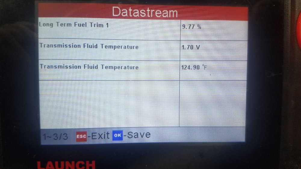

There's technically already a temp guage built into the transmission, its just not hooked to anything and you can only read it with a scan tool...
There's also a thermostat so dont expect to ever see temps below 160 no how big of a cooler you have.
